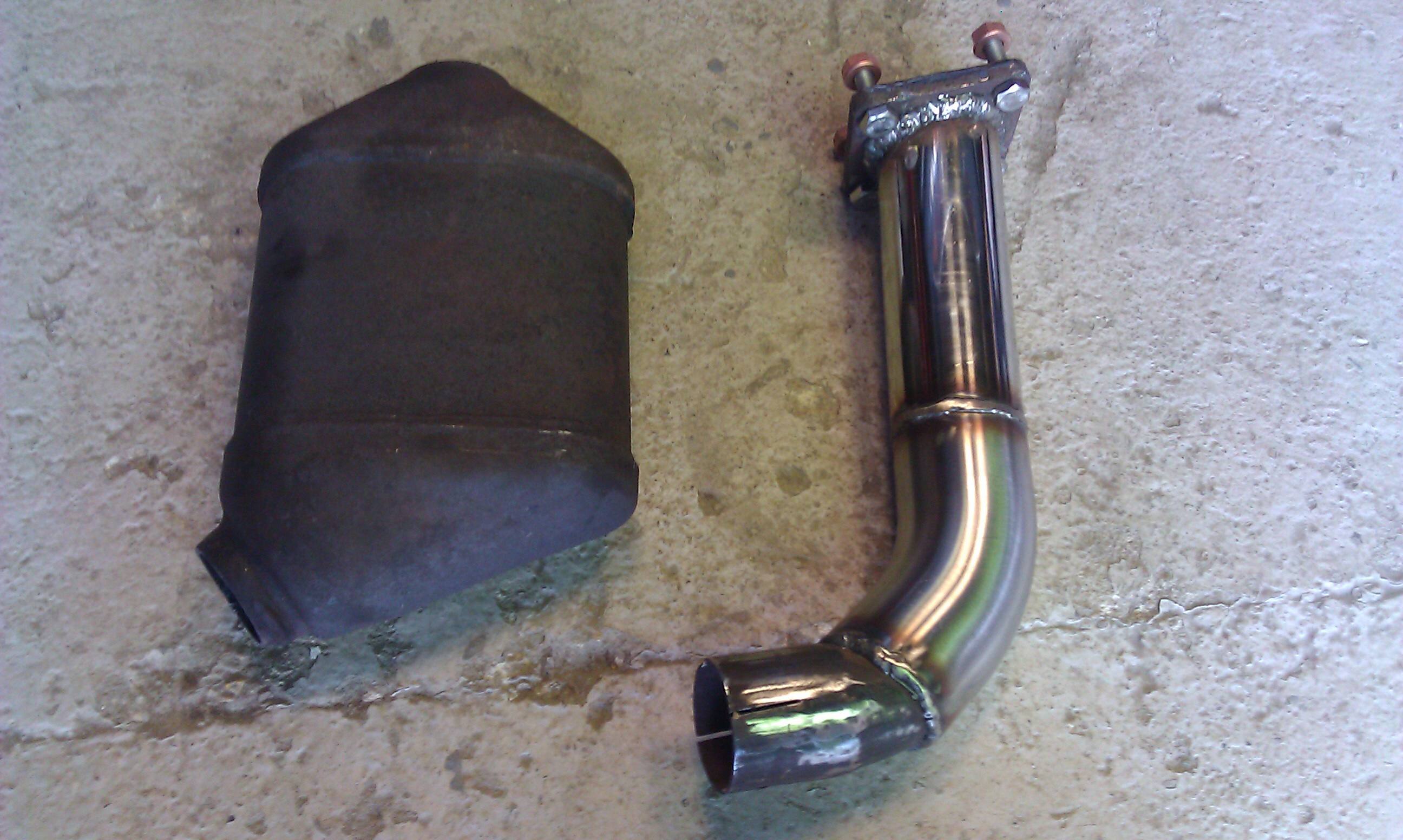

Postby dannyj75 » Thu Apr 24, 2014 11:40 pm
So cat bypass pipe made and installed tonight.
The company take the existing cat and put it in a jig, they then cut out the cat and weld in stainless pipe. They also replaced the studs with bolts which was needed as all the original studs sheered off when removing.
The cost was a bit steep £120 cash, but i did keep the cat and will get some money back when i scrap it.
The pipe fitted fine and the exhaust went back on smoothly.
Power improvement is hard to tell in the short journey completed but it does feel better.
If anyone wants to do the same with their cat, i am sure that any custom exhaust centre can do the same. Problem is getting the cat out and getting it to them! However pm me if you want to use the same company, i will be happy to pass on their details.
