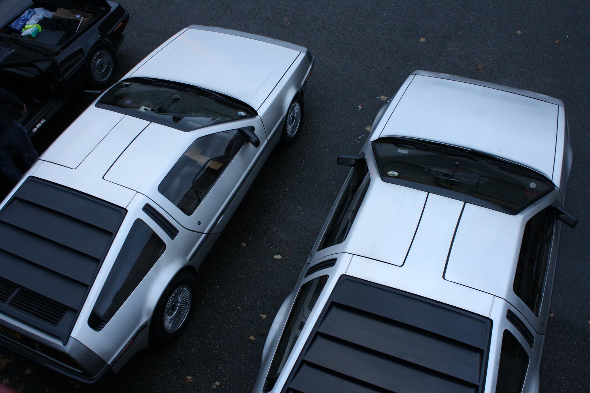

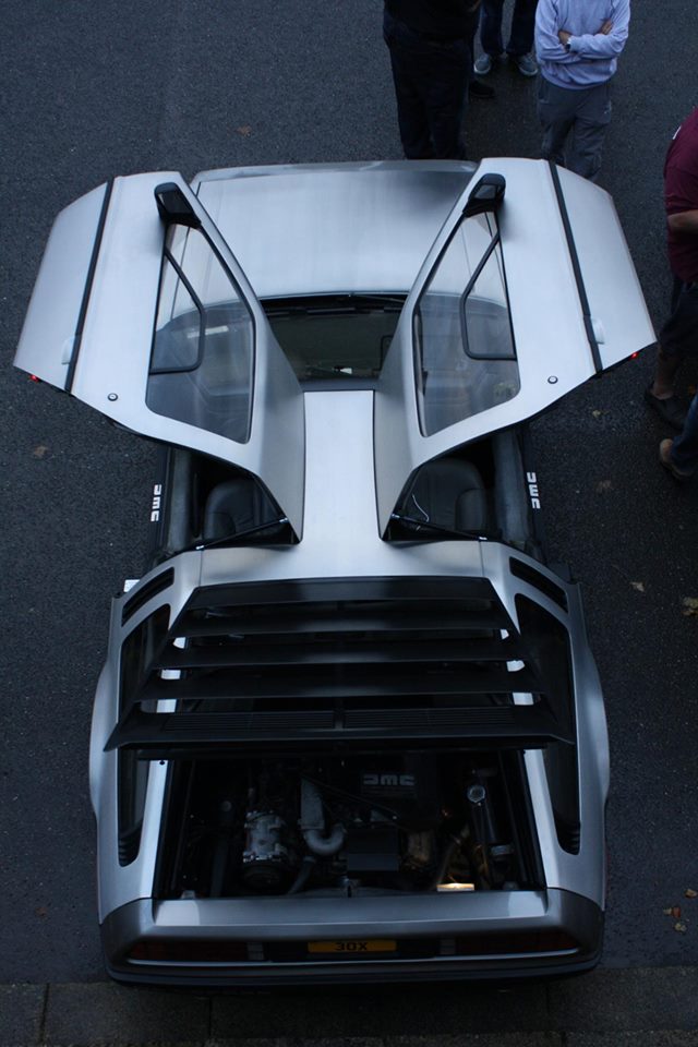

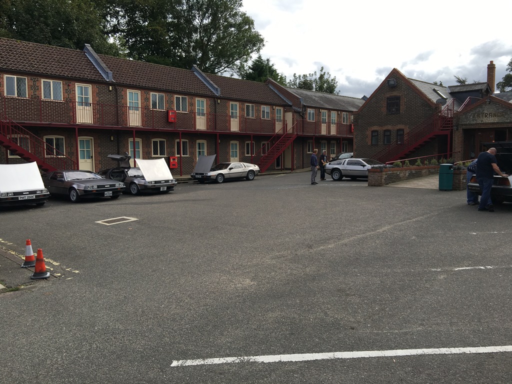

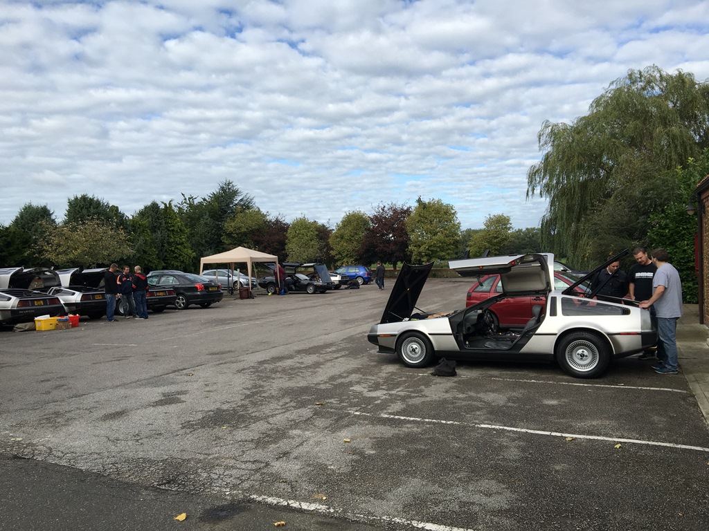

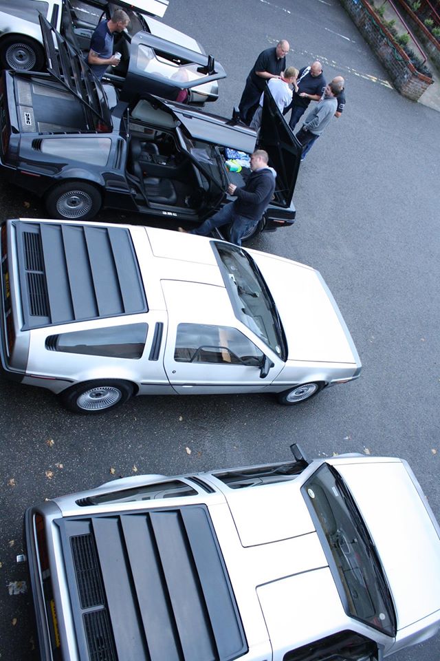

Collection of images - the good ones are from Ryan on Facebook :)
