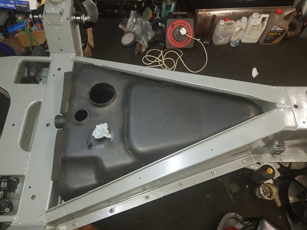

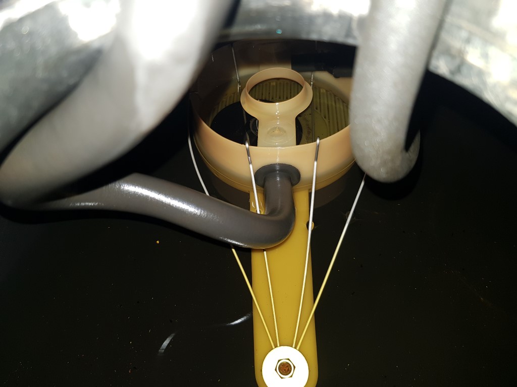

Fuel Tank Cleaned and installed inc internals
20190301_142511 (Medium).jpg (210.8 KiB) Viewed 6629 times
20190227_163214 (Medium).jpg (123.02 KiB) Viewed 6629 times

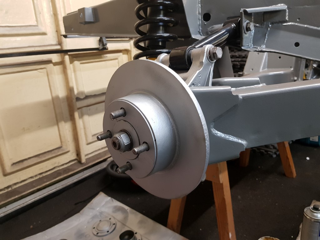

Rear Discs cleaned up and installed
20190302_223251 (Medium).jpg (172.53 KiB) Viewed 6629 times

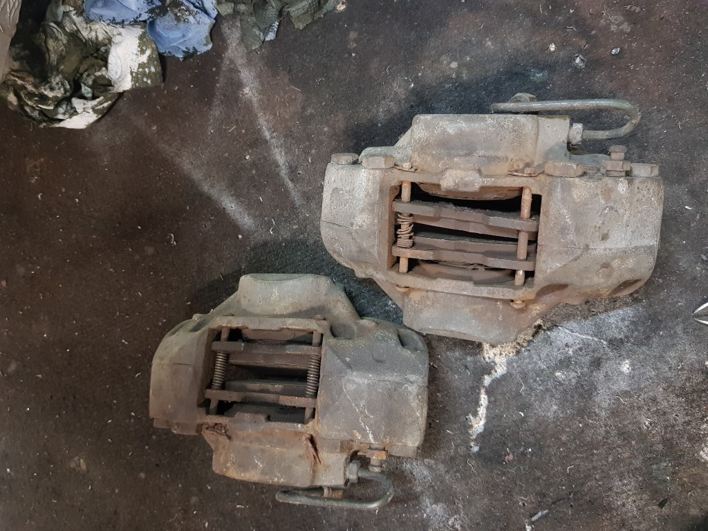

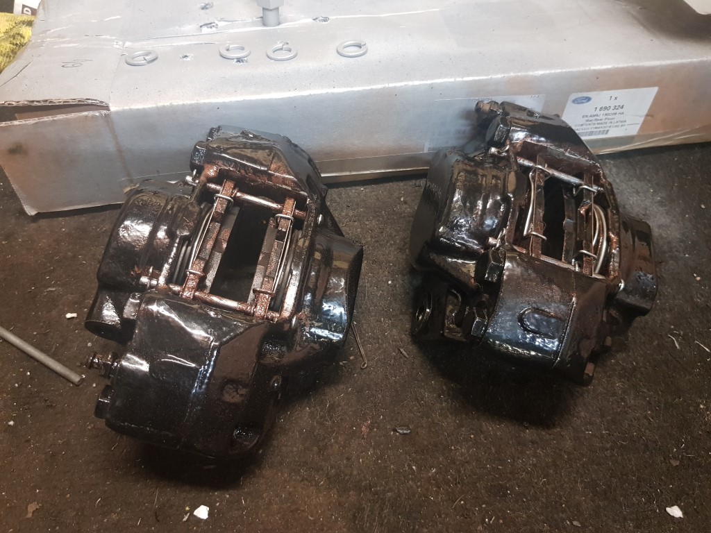

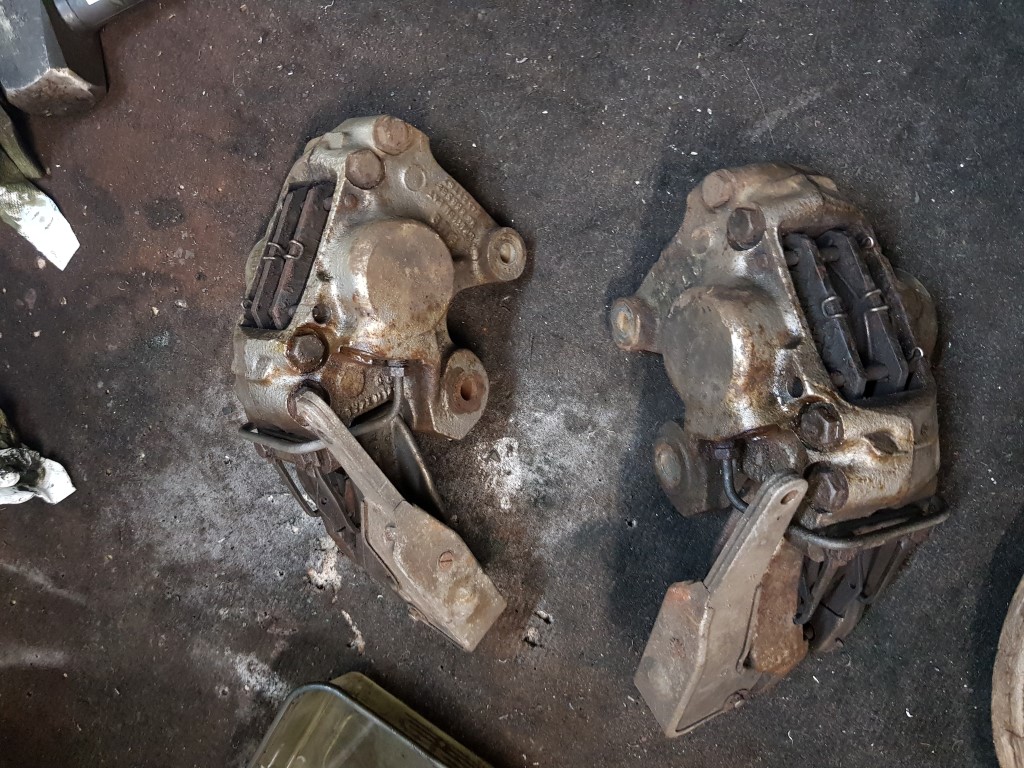

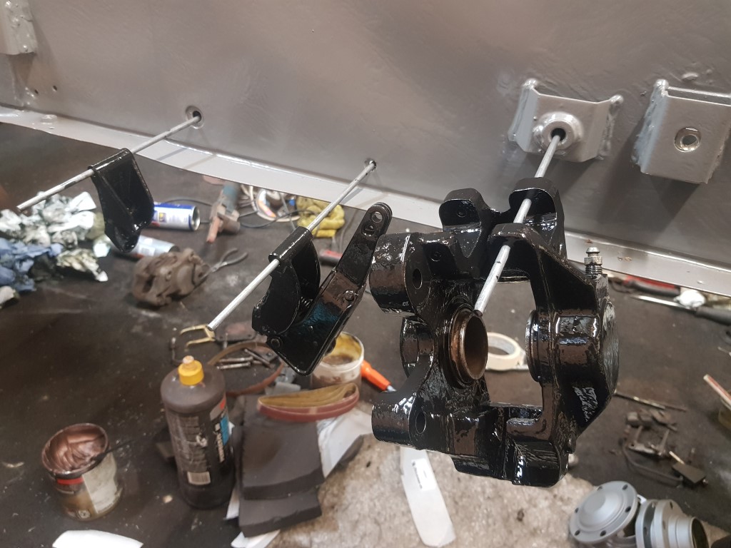

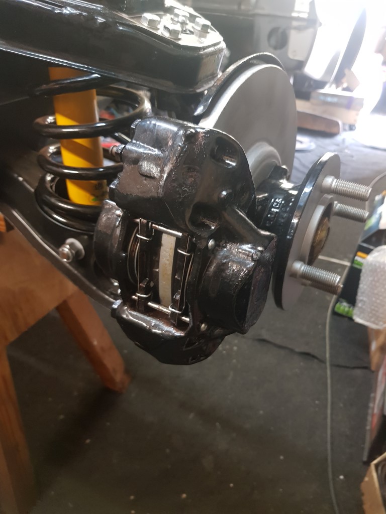

Front and rear calipers Refurbed
Rear Before
20190302_223951 (Medium).jpg (314.79 KiB) Viewed 6629 times
Rear After
20190306_144557 (Medium).jpg (197.63 KiB) Viewed 6629 times
Front Before
20190307_110644 (Medium).jpg (290.27 KiB) Viewed 6629 times
Front After
20190406_115055 (Medium).jpg (222.19 KiB) Viewed 6629 times

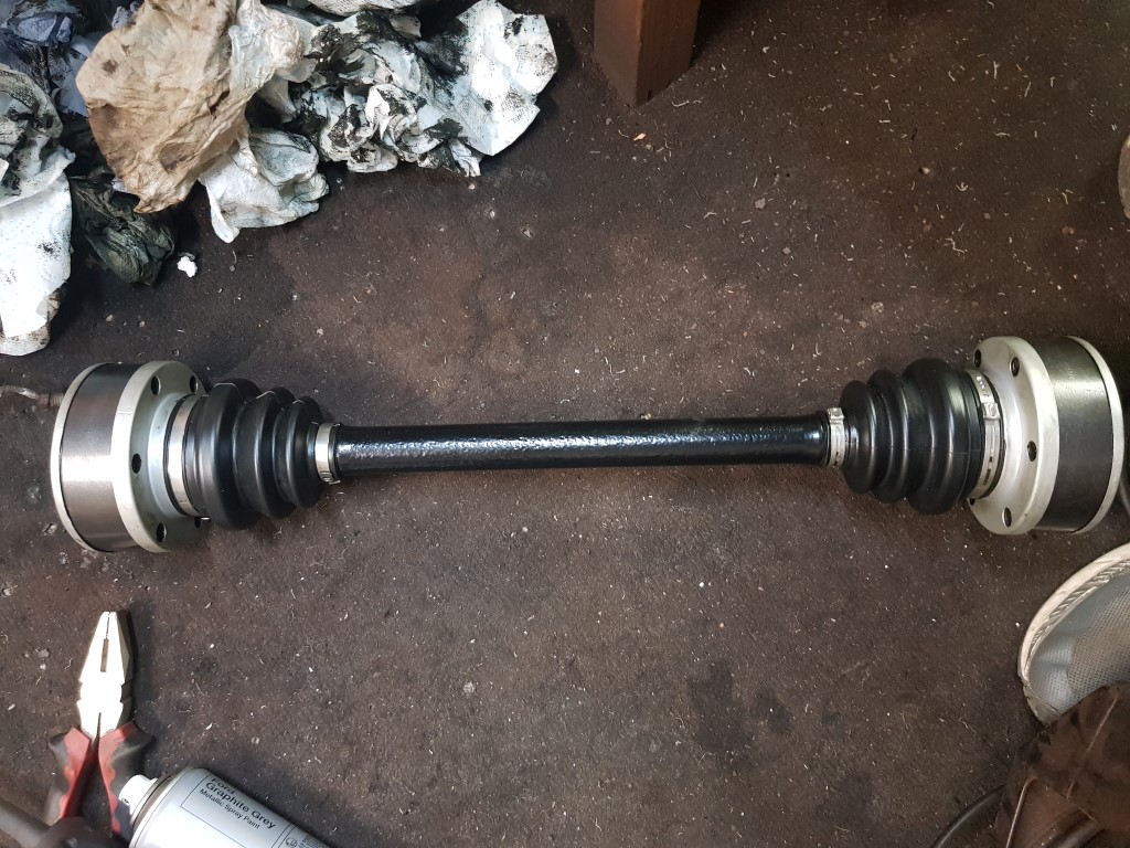

Drive Shafts Re-assembled
20190315_100257 (Medium).jpg (295.99 KiB) Viewed 6629 times

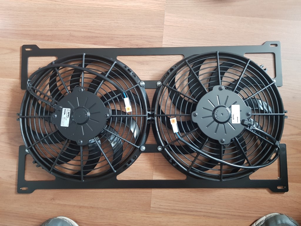

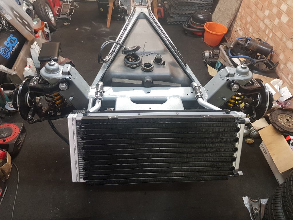

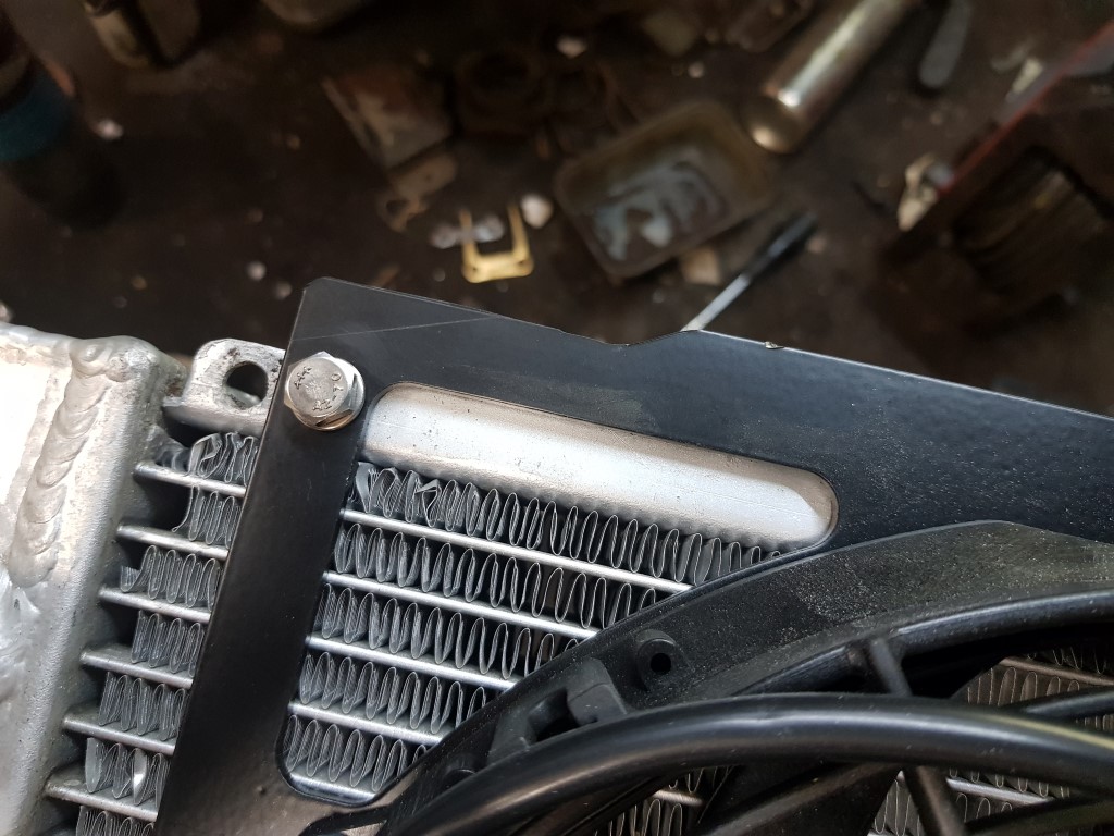

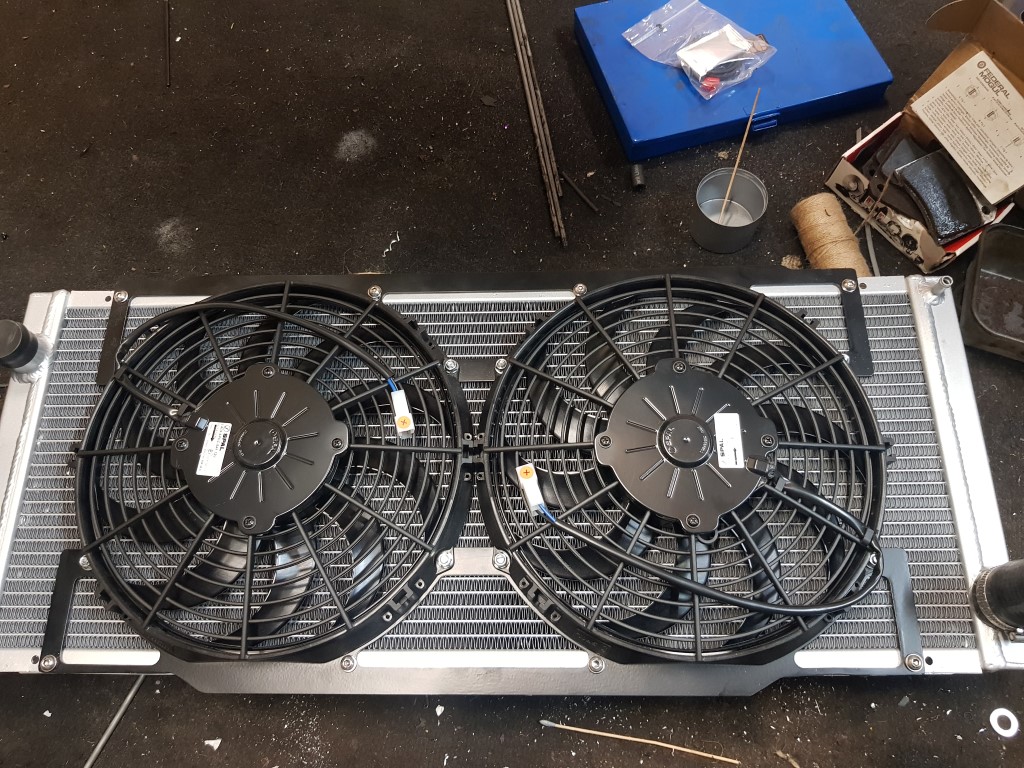

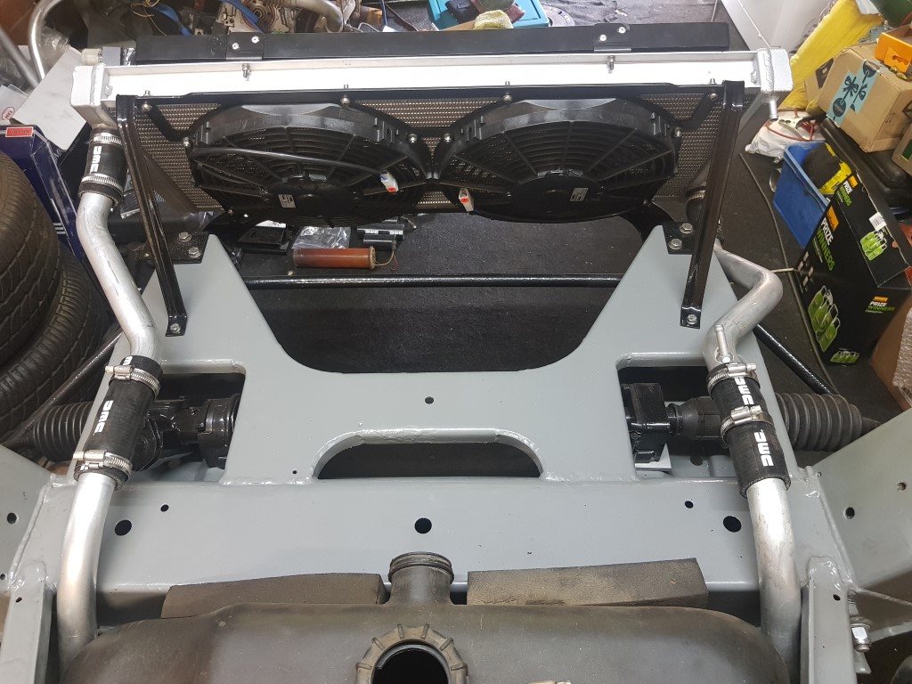

I have chosen a slightly different set of fans for my car, these are made by Pro Alloy for a Sierra Cosworth however with a few small mods they fit the De nicely, they use Spal Fans which are very nice quality..
20190319_123628 (Medium).jpg (253.6 KiB) Viewed 6629 times

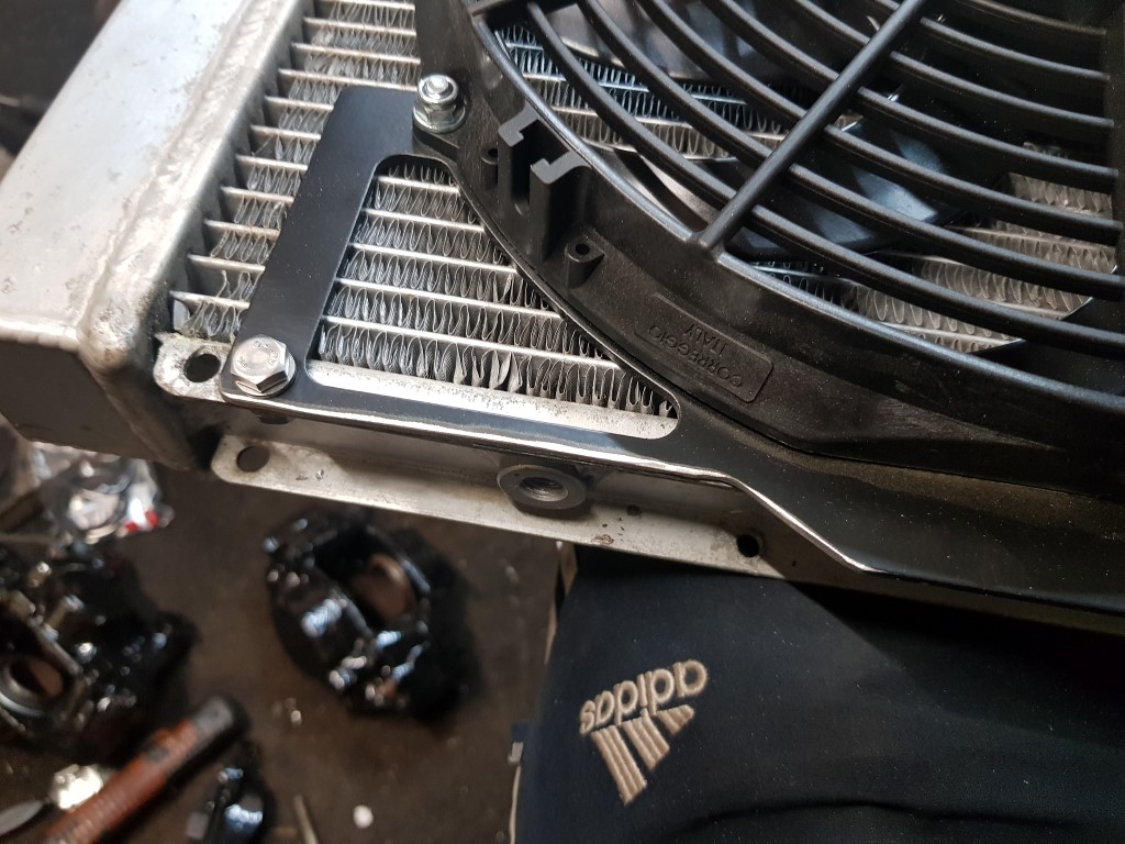

Modded the corners of the frame to fit the De Rad..
20190328_142654 (Medium).jpg (204.37 KiB) Viewed 6629 times
20190328_142658 (Medium).jpg (193.11 KiB) Viewed 6629 times
Repainted and fitted to a new Rad
20190408_142900 (Medium).jpg (306.33 KiB) Viewed 6629 times
20190418_135926 (Medium).jpg (231.69 KiB) Viewed 6629 times
20190418_135951 (Medium).jpg (203.37 KiB) Viewed 6629 times

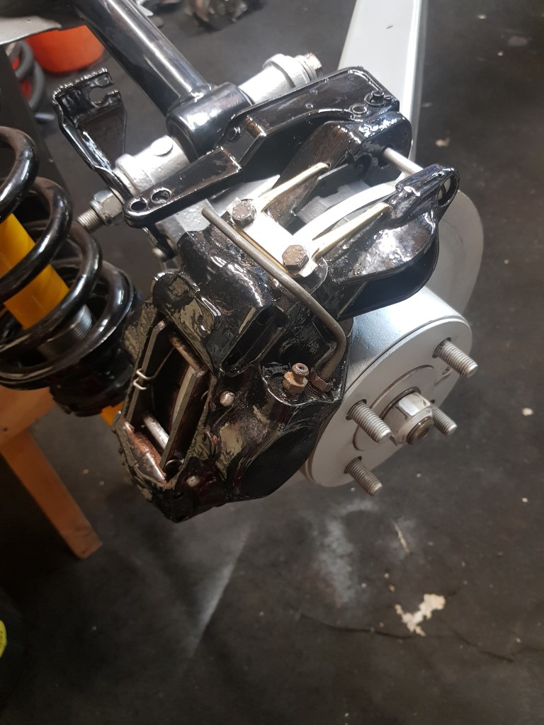

Front and rear calipers installed
20190418_140034 (Medium).jpg (186.7 KiB) Viewed 6629 times
20190418_140048 (Medium).jpg (161.39 KiB) Viewed 6629 times

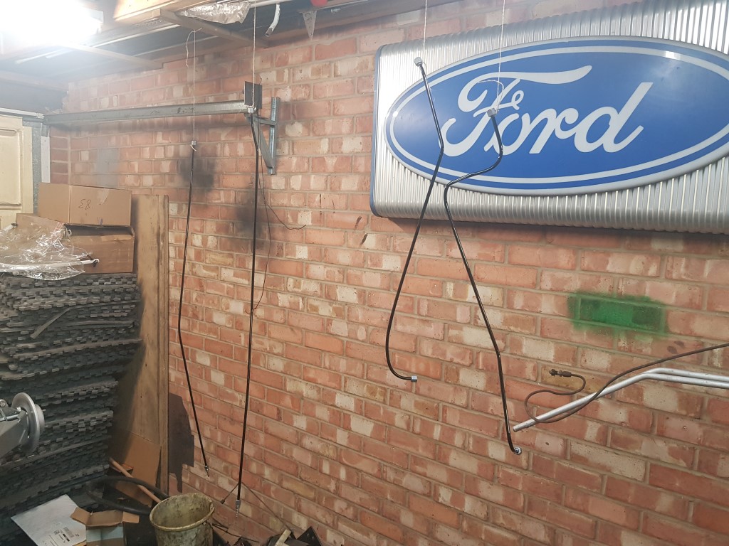

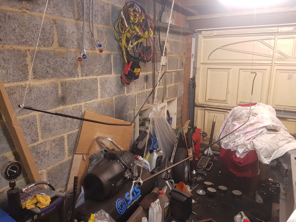

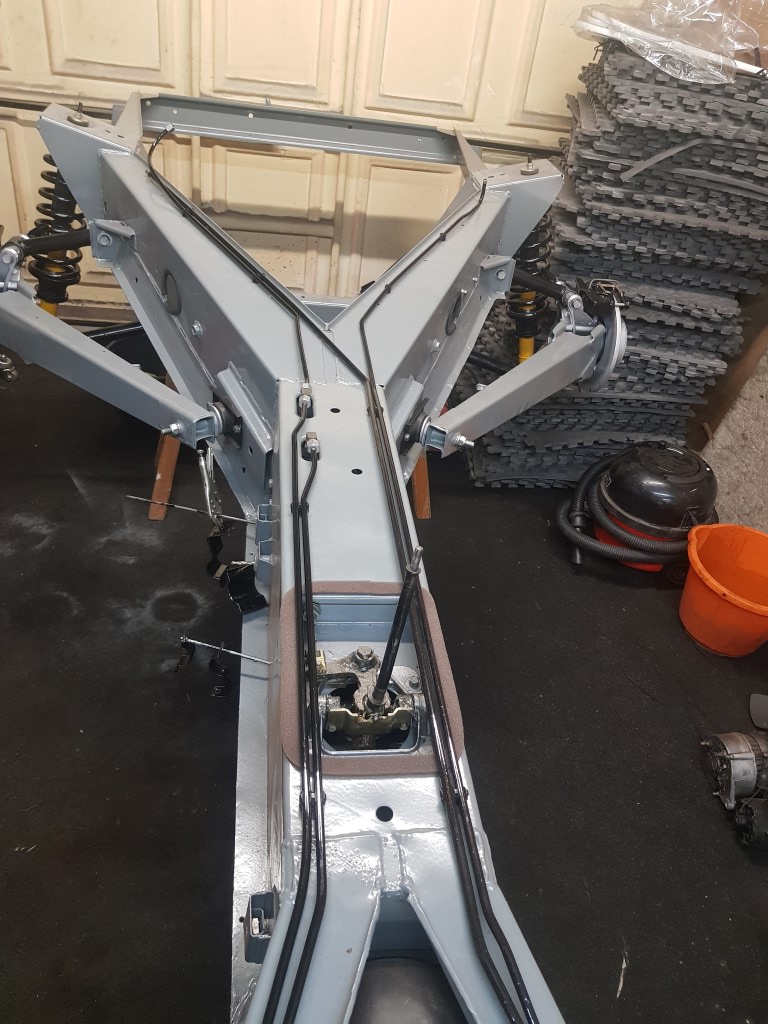

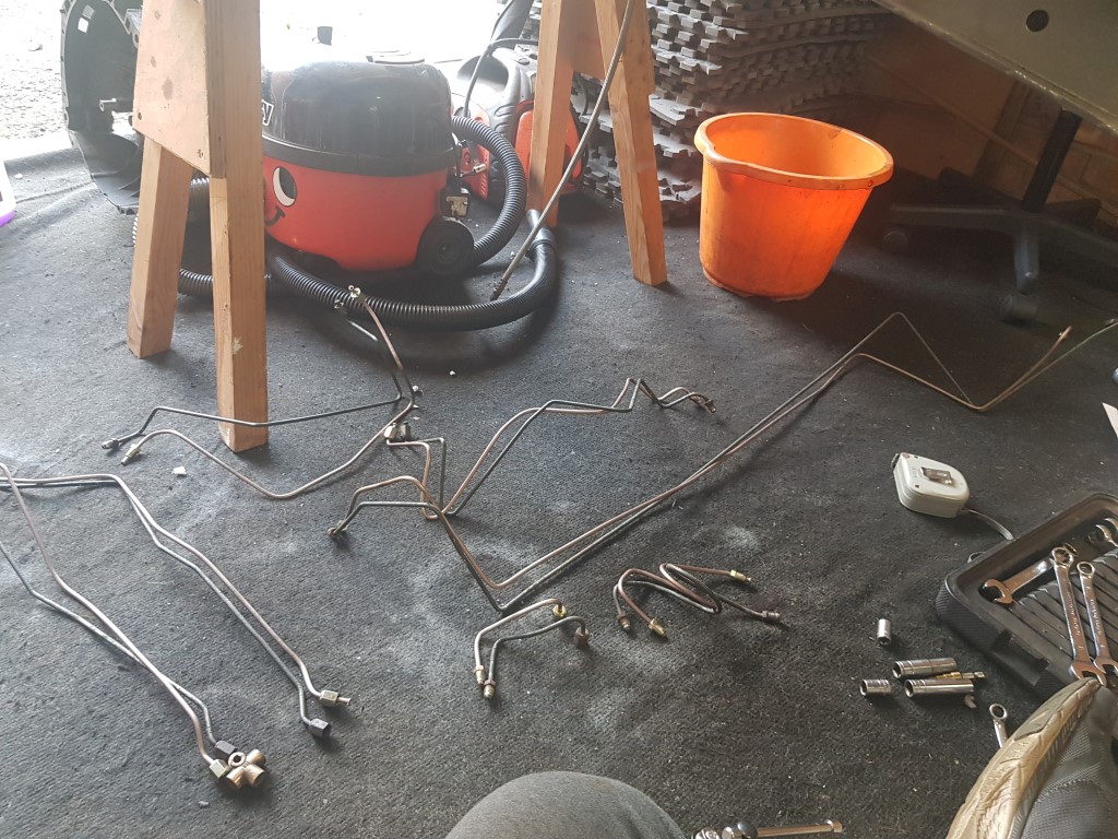

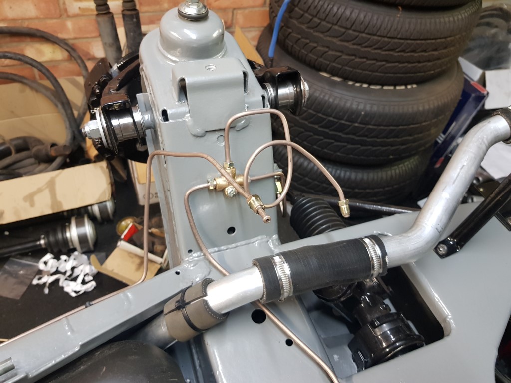

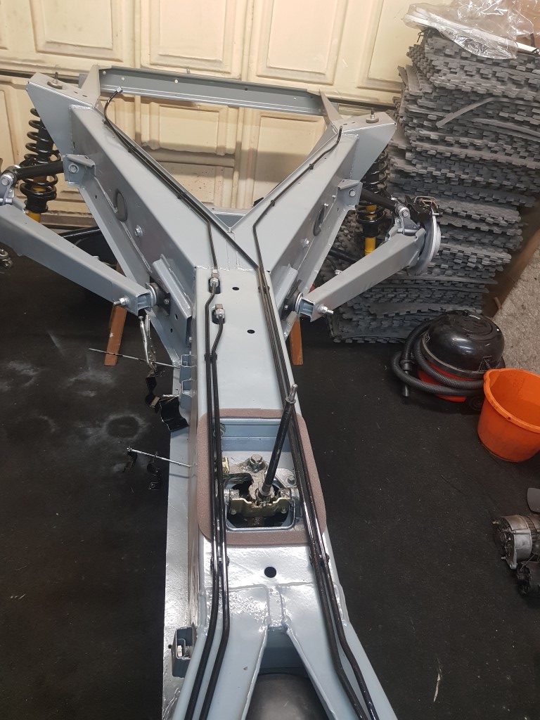

All new brake pipes made by hand
20190501_112246 (Medium).jpg (305.02 KiB) Viewed 6629 times
20190504_153725 (Medium).jpg (175.27 KiB) Viewed 6629 times
20190504_153804 (Medium).jpg (197.16 KiB) Viewed 6629 times

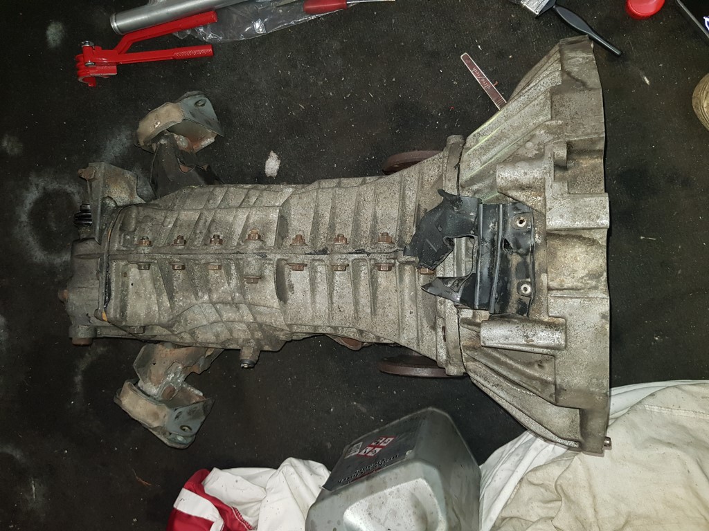

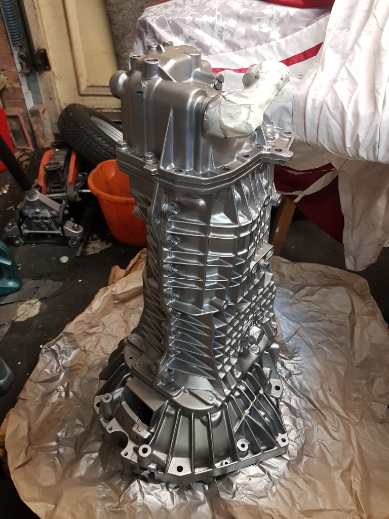

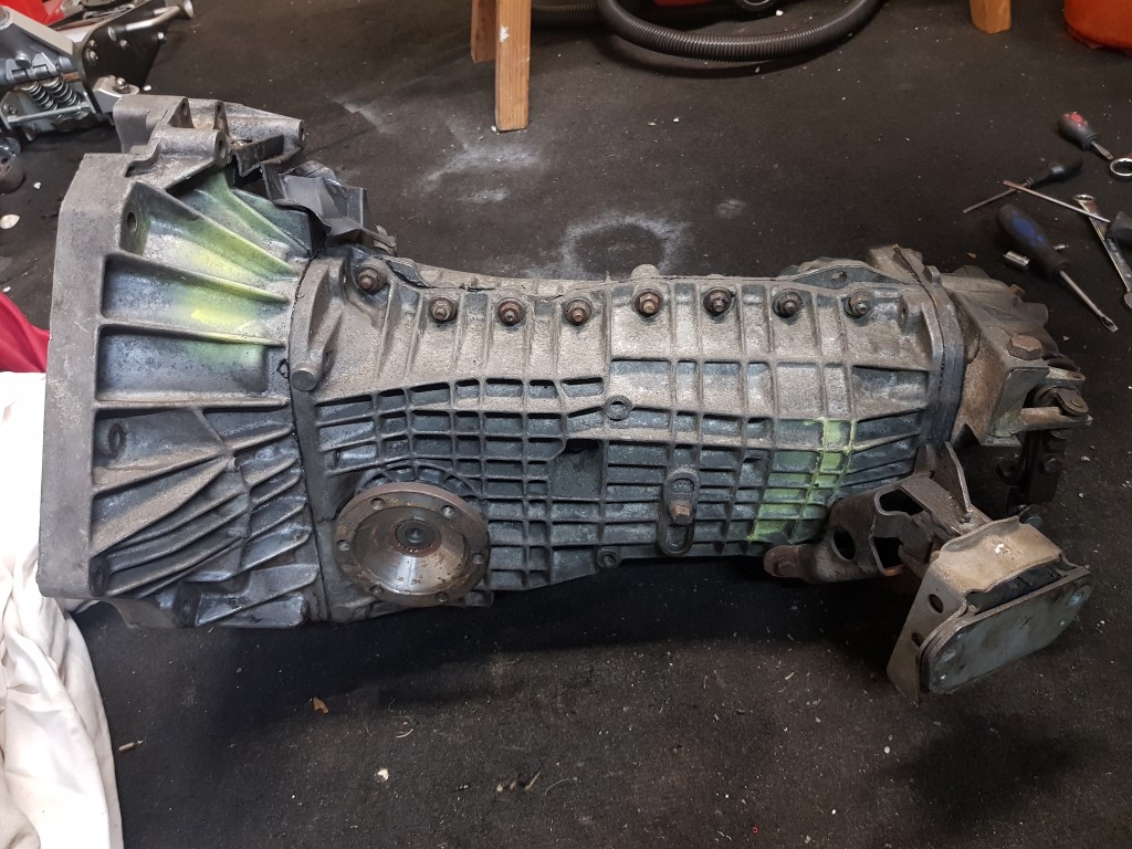

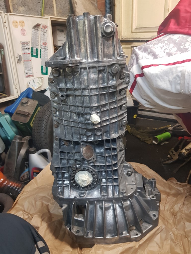

Right onto the gearbox, it has been stripped and checked internally and all new seals replaced but the cosmetic side was letting the side down so heres before
20190508_205440 (Medium).jpg (276.32 KiB) Viewed 6629 times
20190508_205541 (Medium).jpg (236.91 KiB) Viewed 6629 times
During after many many hours of wire brushing
20190513_222417 (Medium).jpg (245.87 KiB) Viewed 6629 times

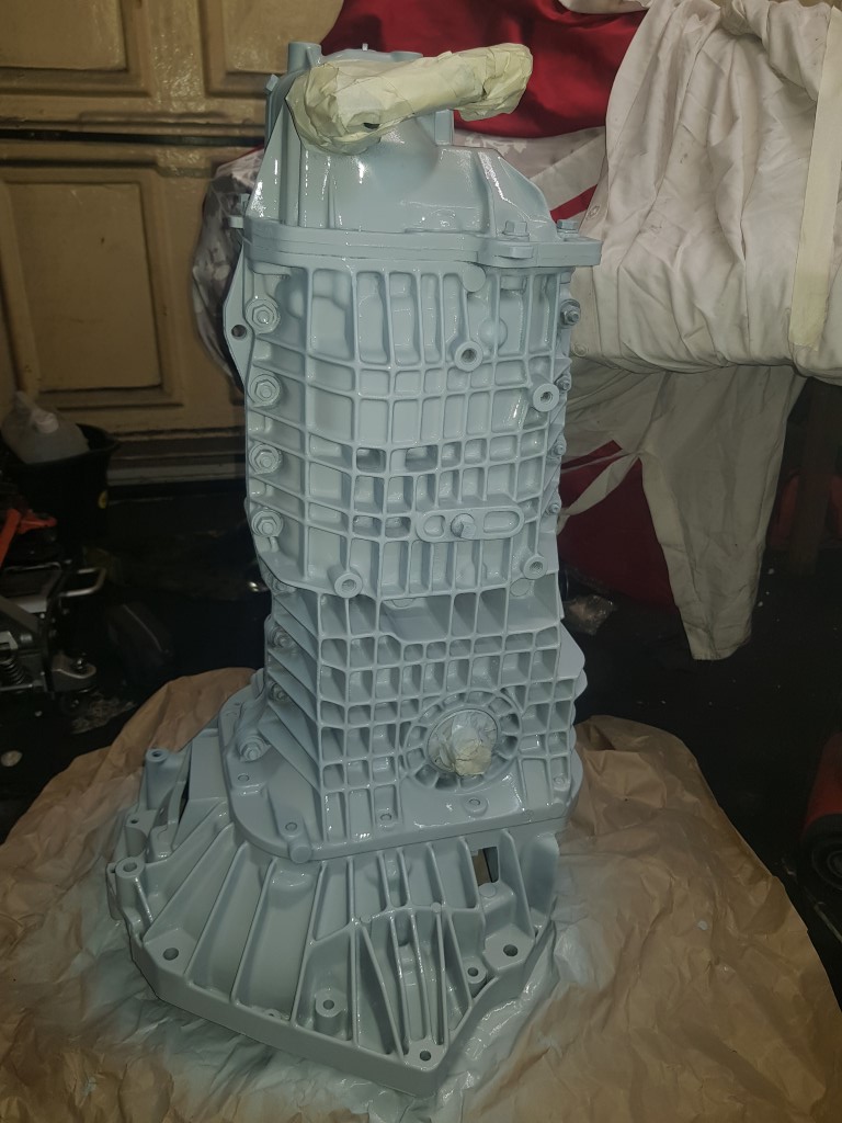

Etch primed
20190513_224242 (Medium).jpg (202.11 KiB) Viewed 6629 times
Painted With POR15 Detail paint
20190516_083117 (Medium).jpg (245.63 KiB) Viewed 6629 times

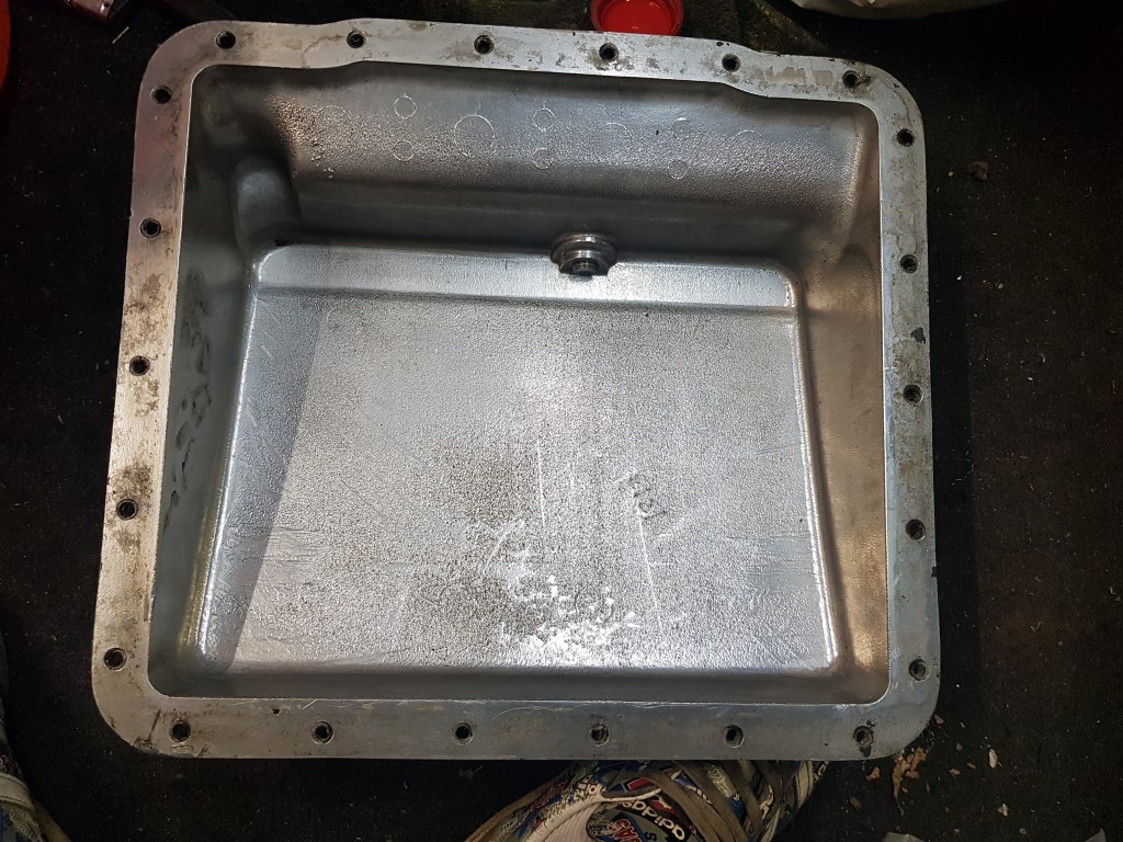

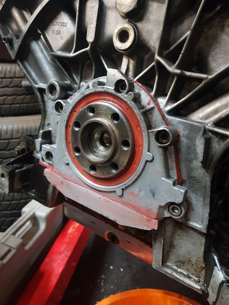

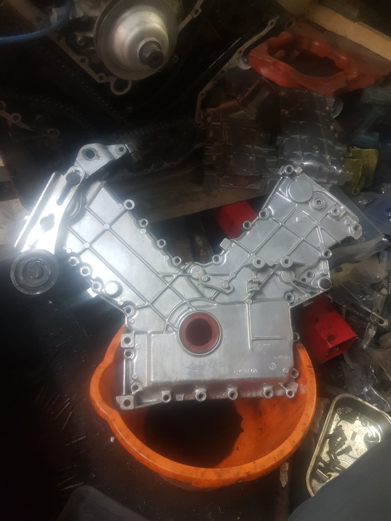

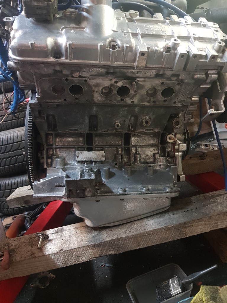

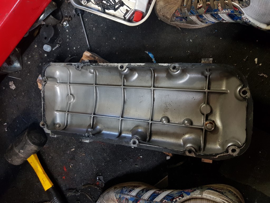

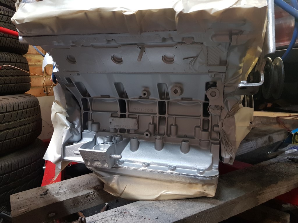

So then we come onto the engine, there was nothing really wrong with it before it was removed just like to leak oil from various places so thats been addressed
The Sump has been removed, cleaned and refitted with a new gasket, also the rocker covers, front crank case have had the same treatment, cleaned with all new gaskets, the rear main sill replaced along with the housing gasket and the front crank sill also replaced.
Whilst i was there the block was looking a bit tired from when i painted it so thats now had new paint and also since the attached pic its had 2 coats of high temp laquer too.
20190514_153620 (Medium).jpg (297.87 KiB) Viewed 6627 times
20190514_164815 (Medium).jpg (164.92 KiB) Viewed 6627 times
20190514_200713 (Medium).jpg (231.38 KiB) Viewed 6627 times
20190514_201722 (Medium).jpg (220.93 KiB) Viewed 6627 times
20190514_232359 (Medium).jpg (171.06 KiB) Viewed 6627 times
20190515_214725 (Medium).jpg (236.76 KiB) Viewed 6627 times
20190516_083139 (Medium).jpg (180.02 KiB) Viewed 6627 times
I have installed all new exhaust studs and of course new manifold gaskets too

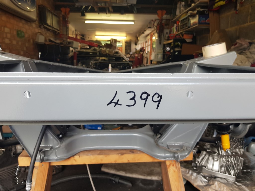

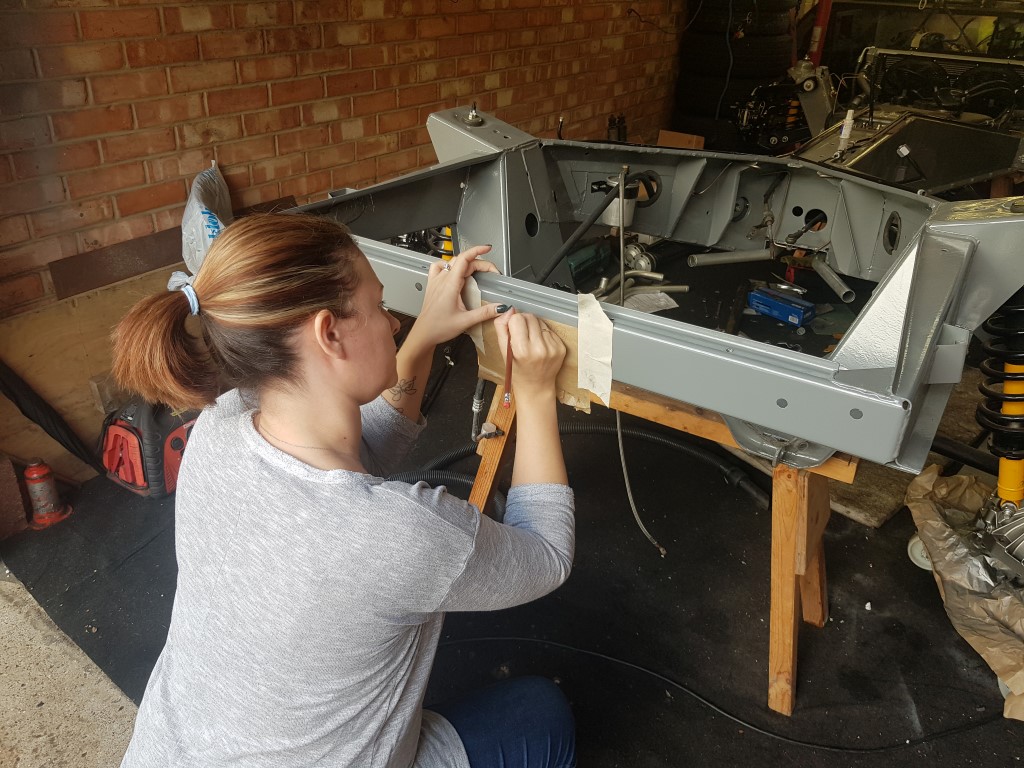

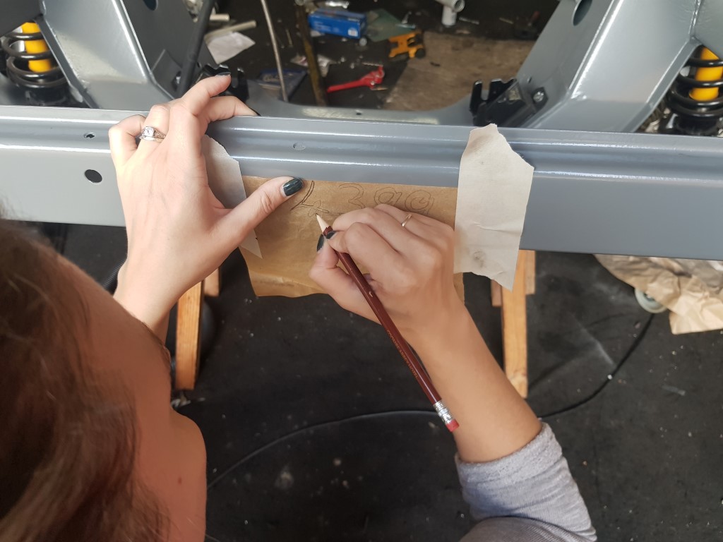

Before the chassis went to be dipped i traced the original number off the back of it so it could be reinstated, Gem traced it back on for me so i could re write it in marker pen just like the factory did..
20190518_111604 (Medium).jpg (265.94 KiB) Viewed 6627 times
20190518_111620 (Medium).jpg (136.22 KiB) Viewed 6627 times
20190518_112535 (Medium).jpg (187.15 KiB) Viewed 6627 times

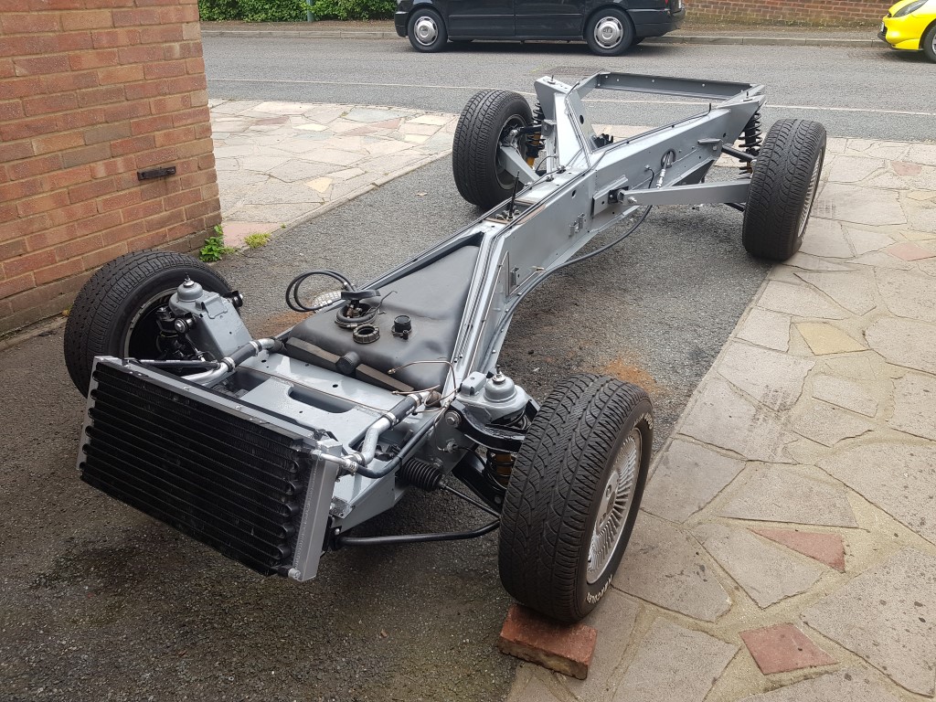

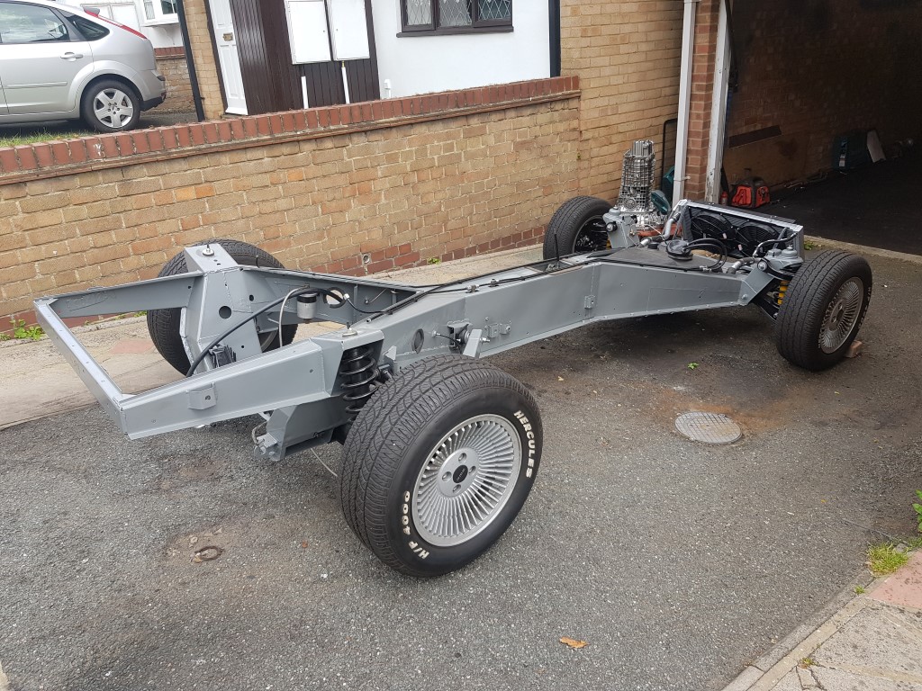

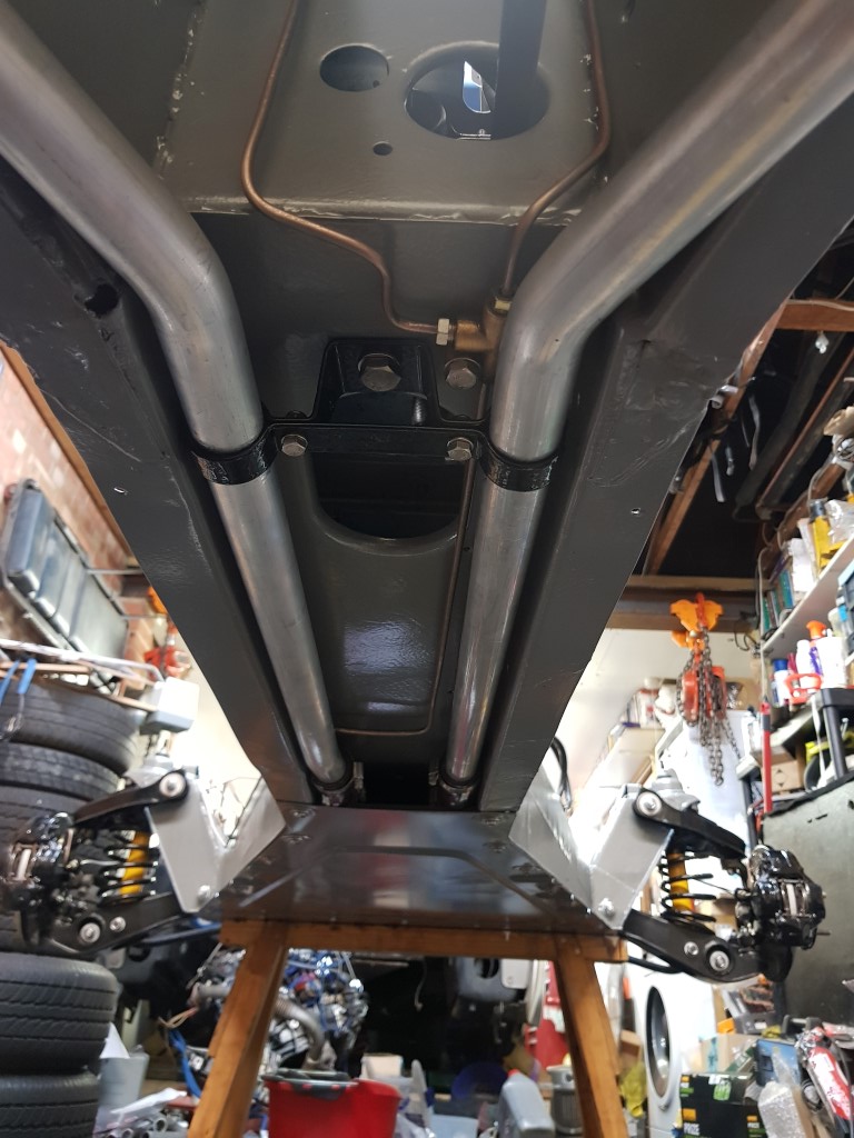

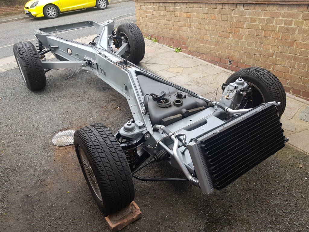

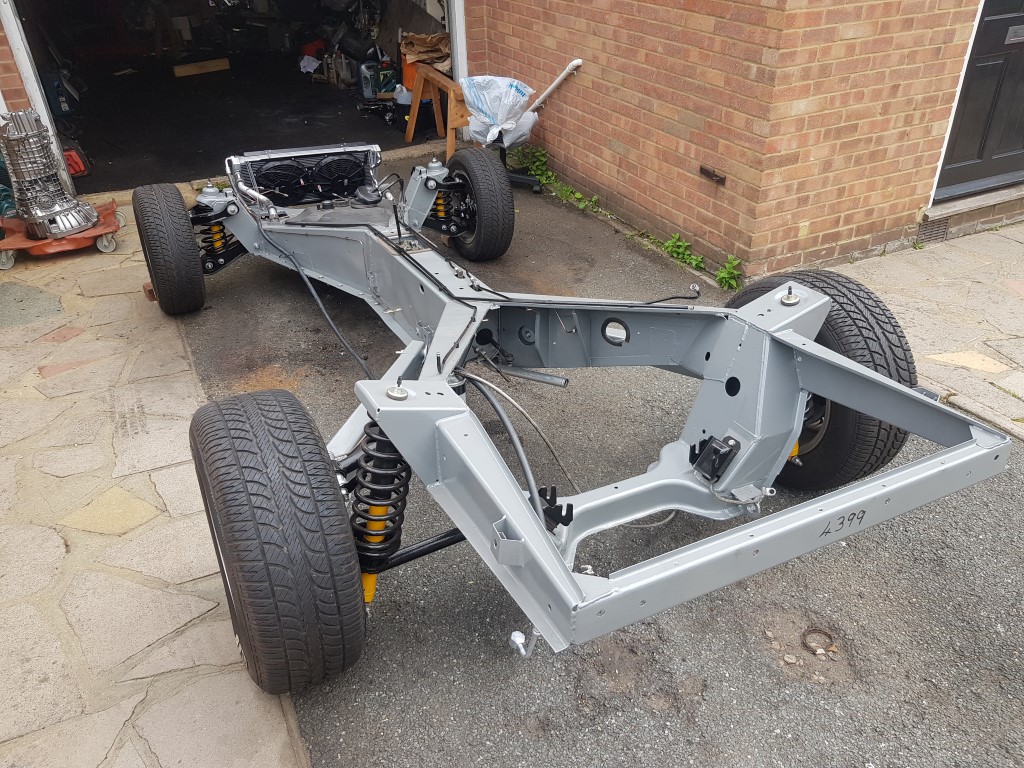

Then Yesterday the Chassis rolled on its wheels for the 1st time in over 6 months
20190518_133625 (Medium).jpg (411.13 KiB) Viewed 6627 times
20190518_133616 (Medium).jpg (376.42 KiB) Viewed 6627 times
20190518_133558 (Medium).jpg (366 KiB) Viewed 6627 times
20190518_133548 (Medium).jpg (364.98 KiB) Viewed 6627 times

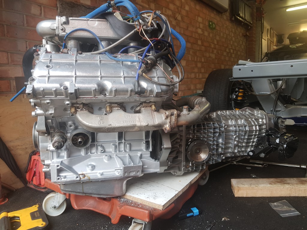

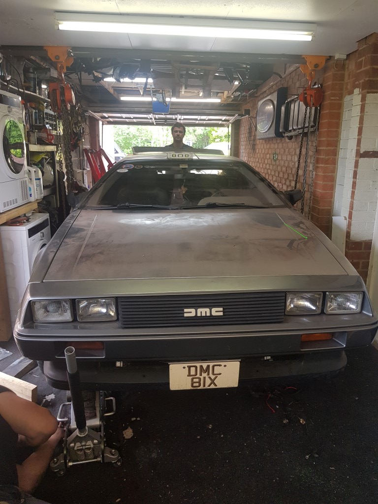

So then we come to today, the engine and box are now together
20190519_075232 (Medium).jpg (280.79 KiB) Viewed 6627 times

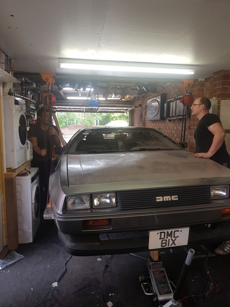

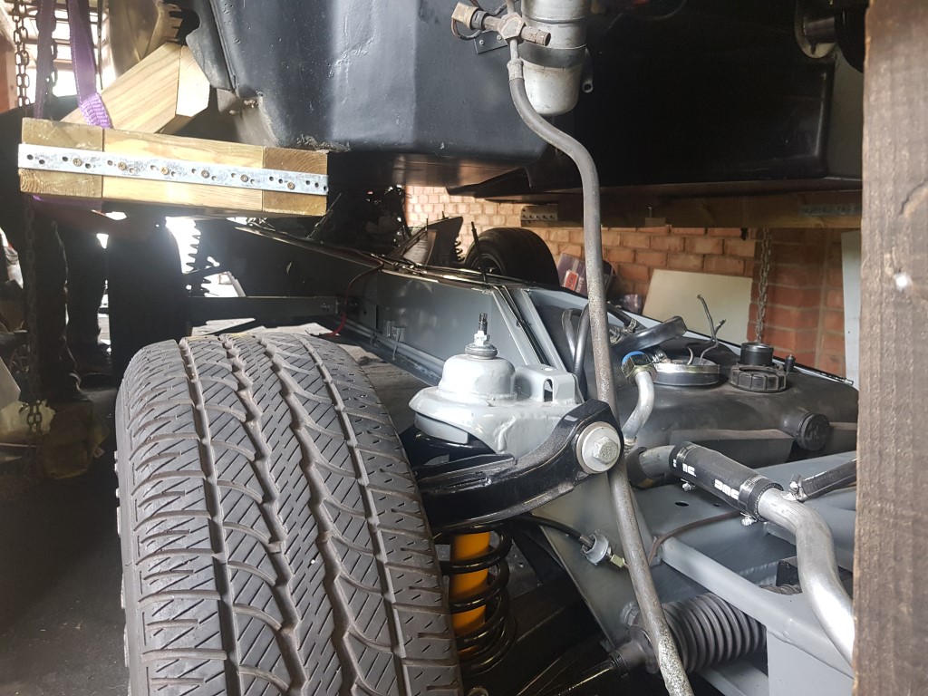

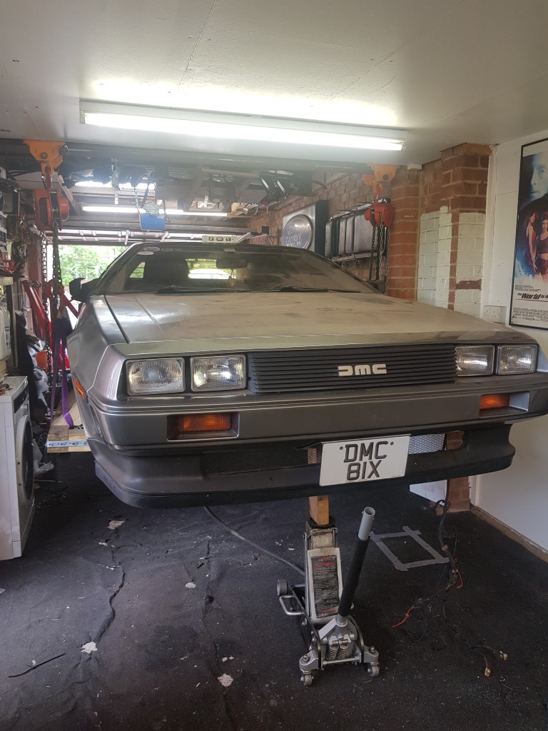

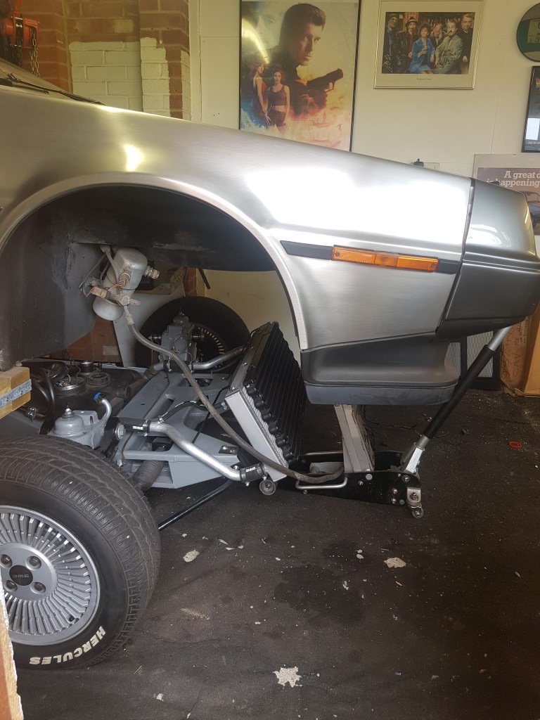

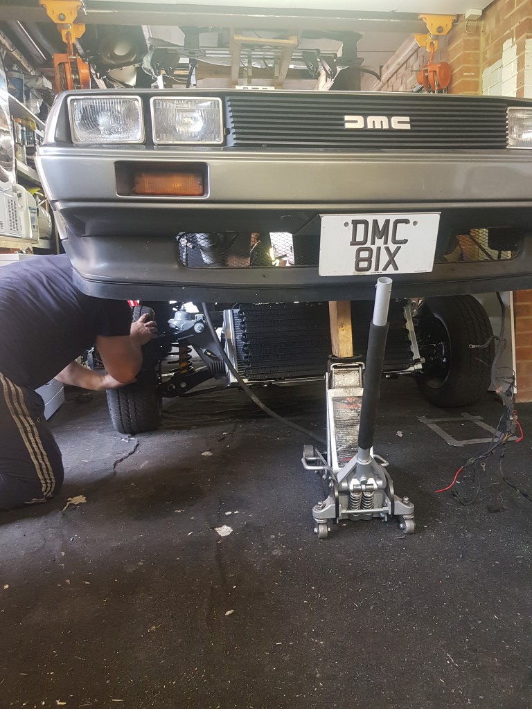

This is now in the chassis and my old mate Alex came over this morn for some "Body" Action ;)
20190519_093922 (Medium).jpg (226.1 KiB) Viewed 6627 times
20190519_094437 (Medium).jpg (237.98 KiB) Viewed 6627 times
20190519_094701 (Medium).jpg (278.44 KiB) Viewed 6627 times
20190519_094845 (Medium).jpg (236.79 KiB) Viewed 6627 times
20190519_095741 (Medium).jpg (267.71 KiB) Viewed 6627 times
20190519_100927 (Medium).jpg (246.7 KiB) Viewed 6627 times

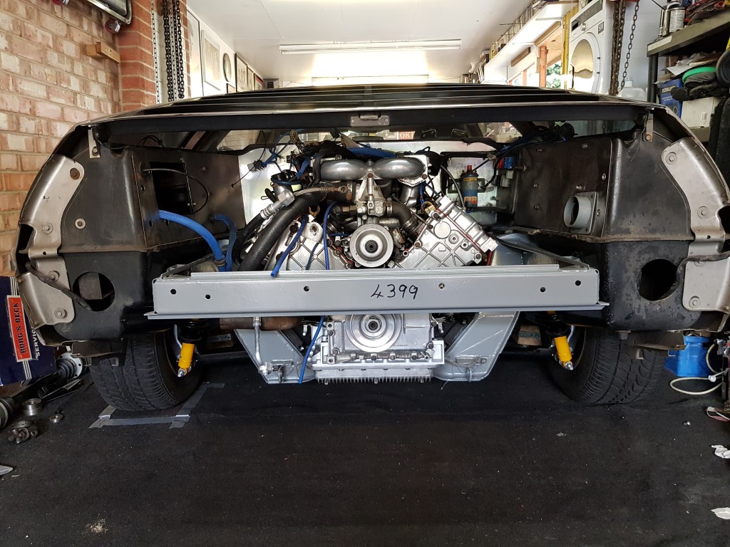

So the Eagle has landed !!
20190519_103016 (Medium).jpg (237.8 KiB) Viewed 6627 times
20190519_115124 (Medium).jpg (284.02 KiB) Viewed 6627 times
Now i just gota work out how the rest of it goes back together !! :shock: :dance: :dance: :dmcdoors: :dmcdoors:
