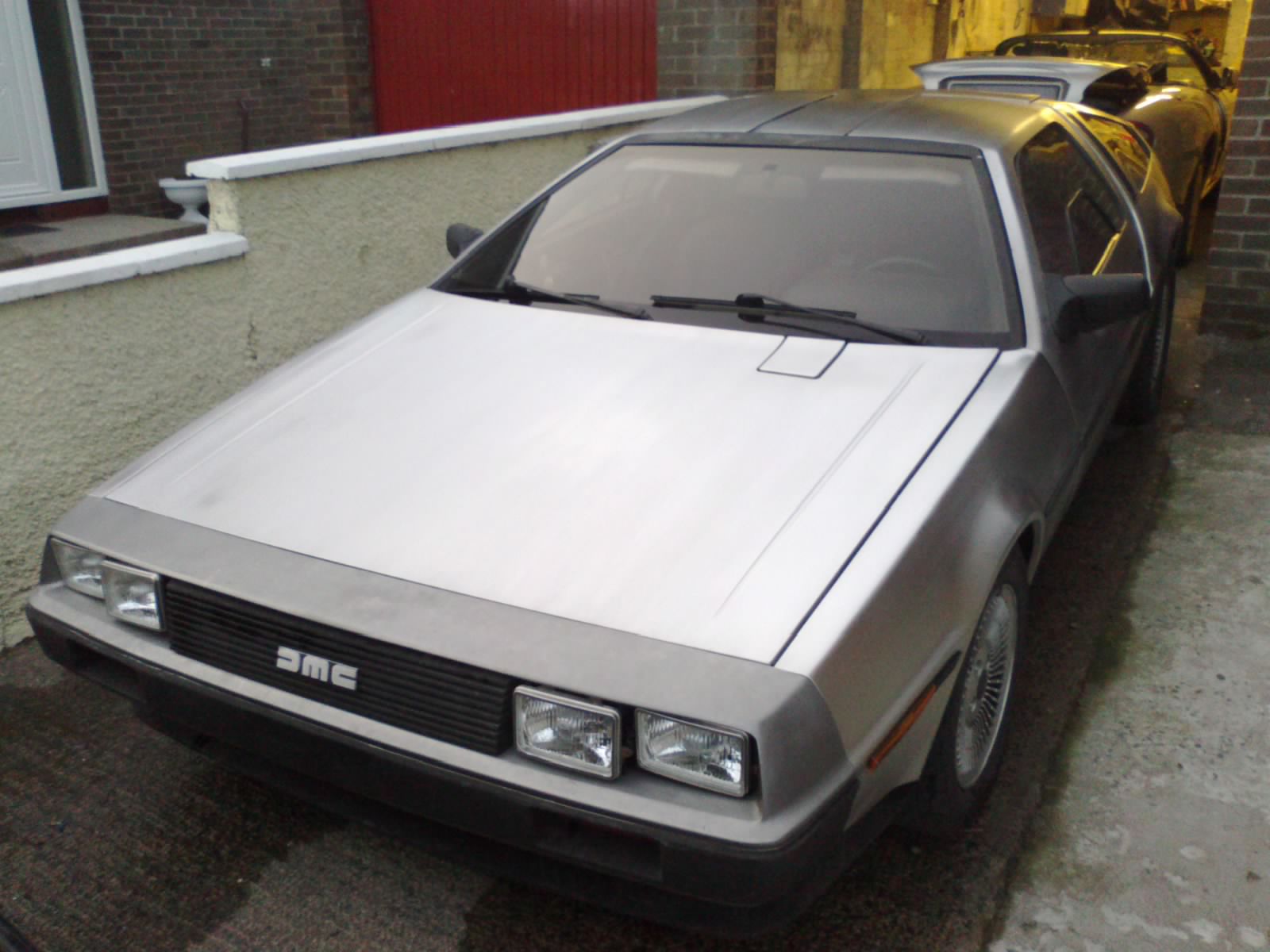

Inner headlights need holes made to mount due to extra sidelights so that is why they sit out.
