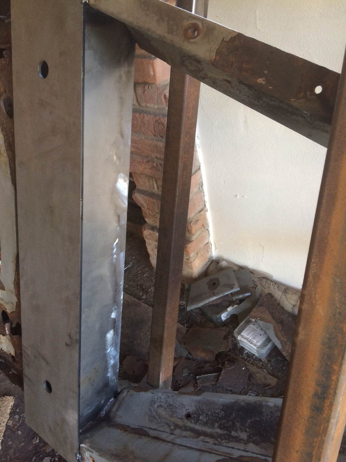

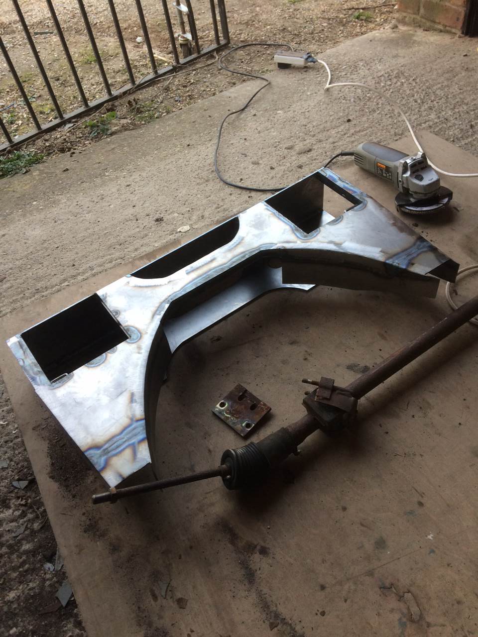

Postby clocktown64dd » Tue Apr 14, 2015 6:16 pm

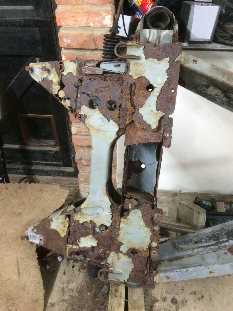

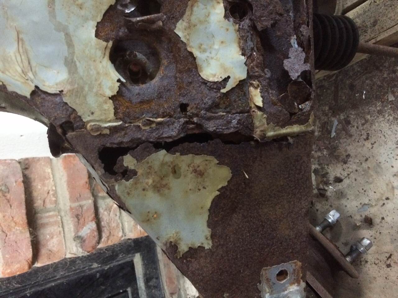

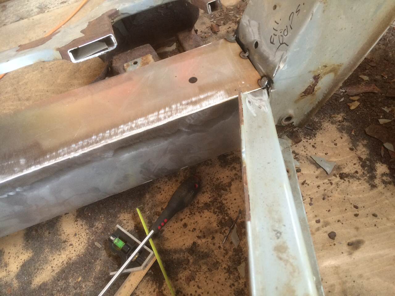

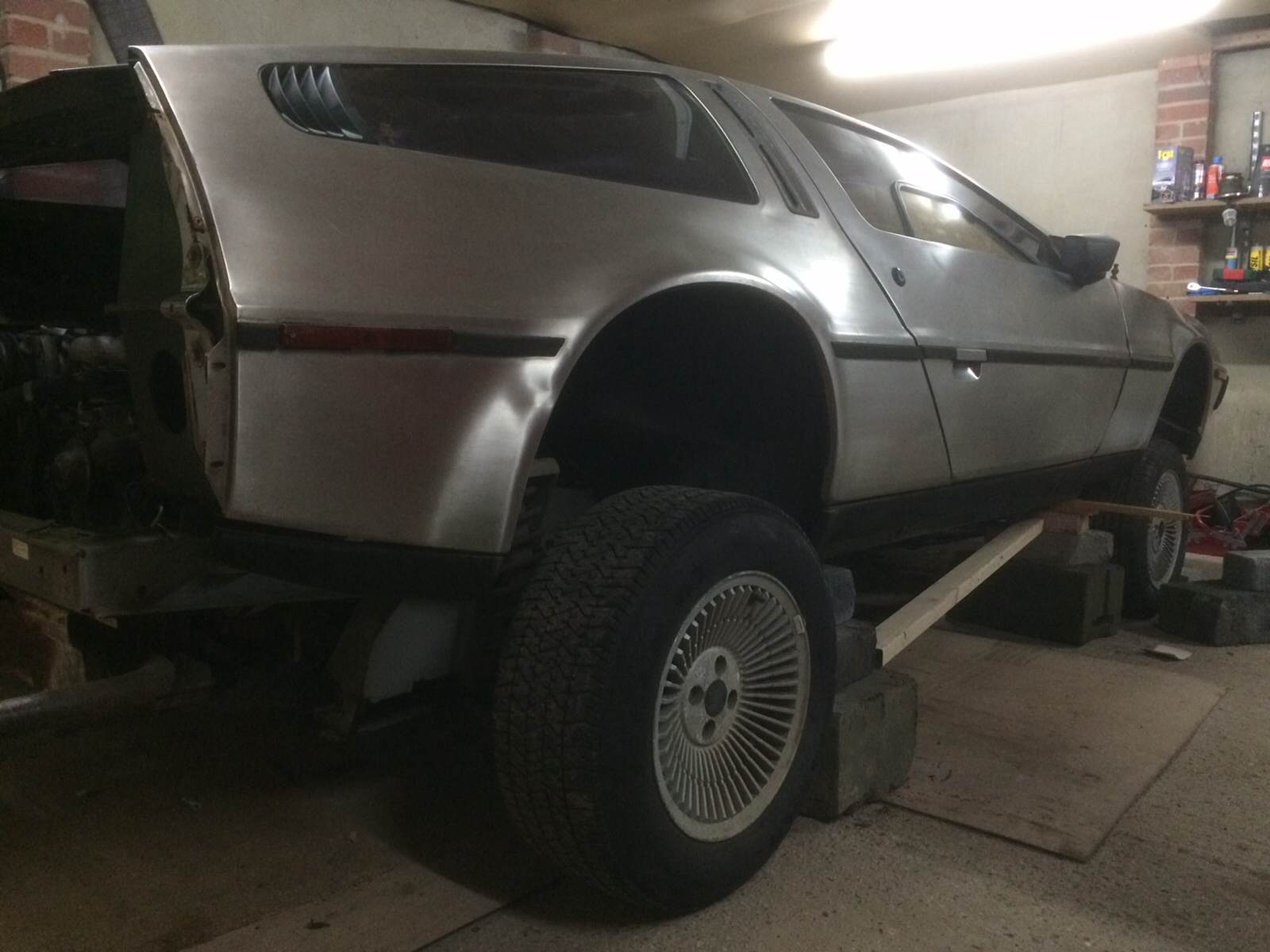

Chassis is now underway, the front was rotten as hell. I'm fabricating a whole new front end including the cross member. Cross member is fitted I'm now just waiting on a few small bits of steel to do the front. Then once the back is played in time for the finishing! May just get it blasted then galvanised as the inner parts of the frame are literally brand new. Shame about the front!! Will post pics soon keep sting that but I will!

If you're going to fabricate a new front end, how about you cover your costs by making a run of them and sell them on?
clocktown64dd wrote:Chassis is now underway, the front was rotten as hell. I'm fabricating a whole new front end including the cross member. Cross member is fitted I'm now just waiting on a few small bits of steel to do the front. Then once the back is played in time for the finishing! May just get it blasted then galvanised as the inner parts of the frame are literally brand new. Shame about the front!! Will post pics soon keep sting that but I will!
Re: imported from tennesse, to norfolk.. restoration begins!
Postby clocktown64dd » Tue Apr 14, 2015 10:09 pm
Is there anyone out there that would like one made? It's very slightly different from the original, which is shit, I've strengthened the front part and made the whole top section much stronger and reduced the water traps, it's much stronger than the original and fully welded not "stitched" so again less water traps.

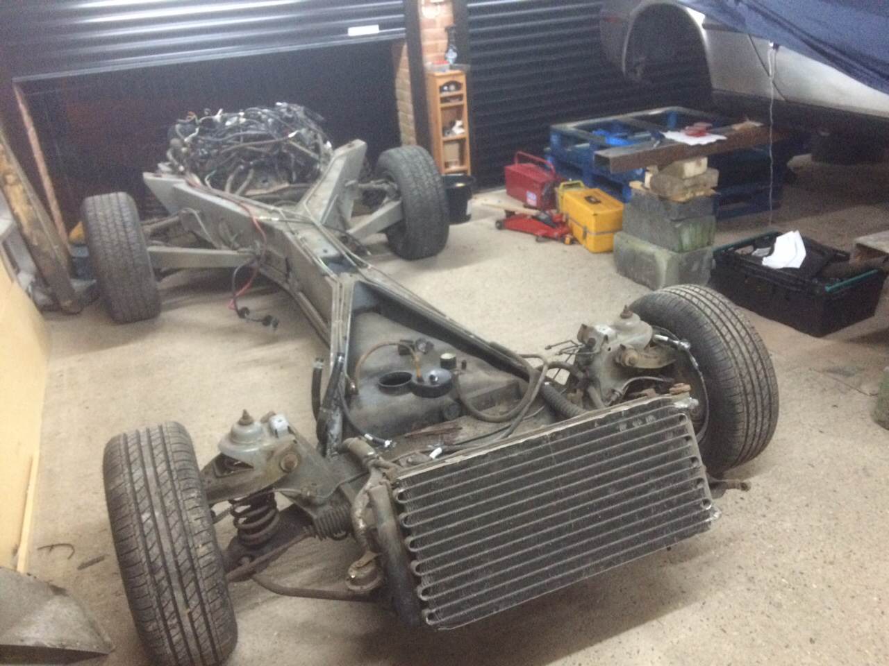

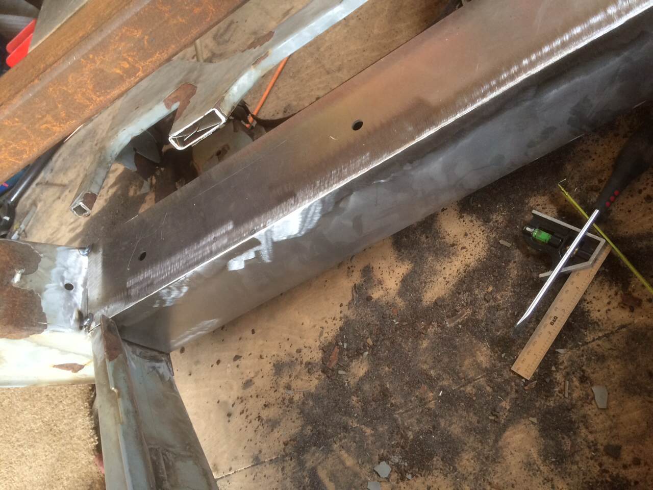

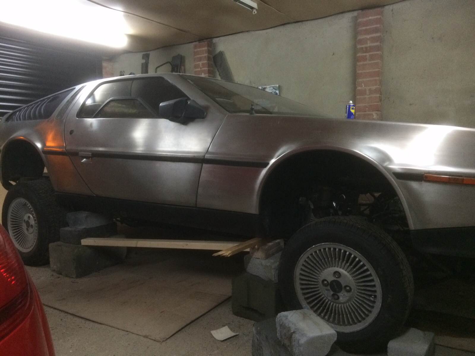

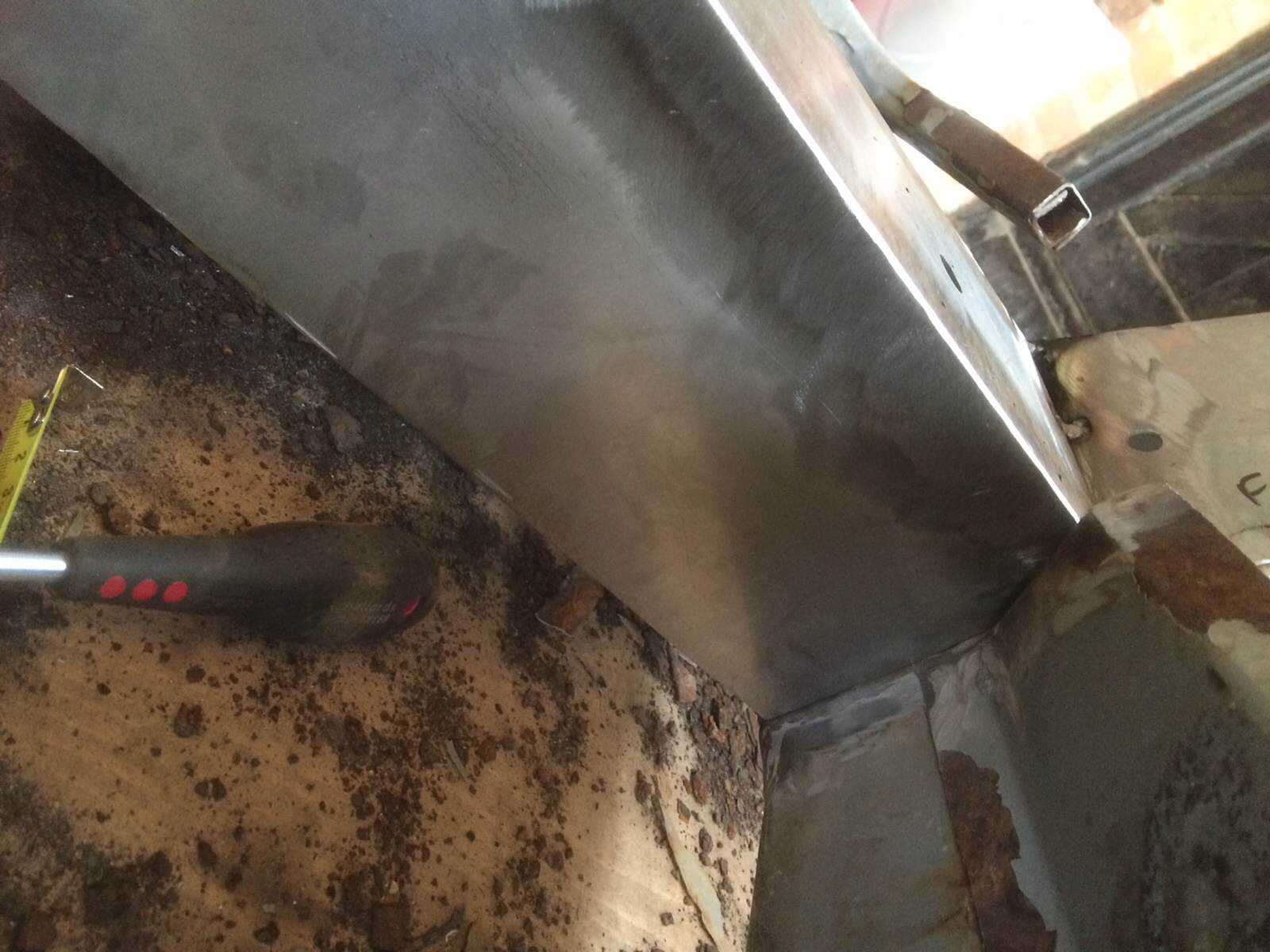

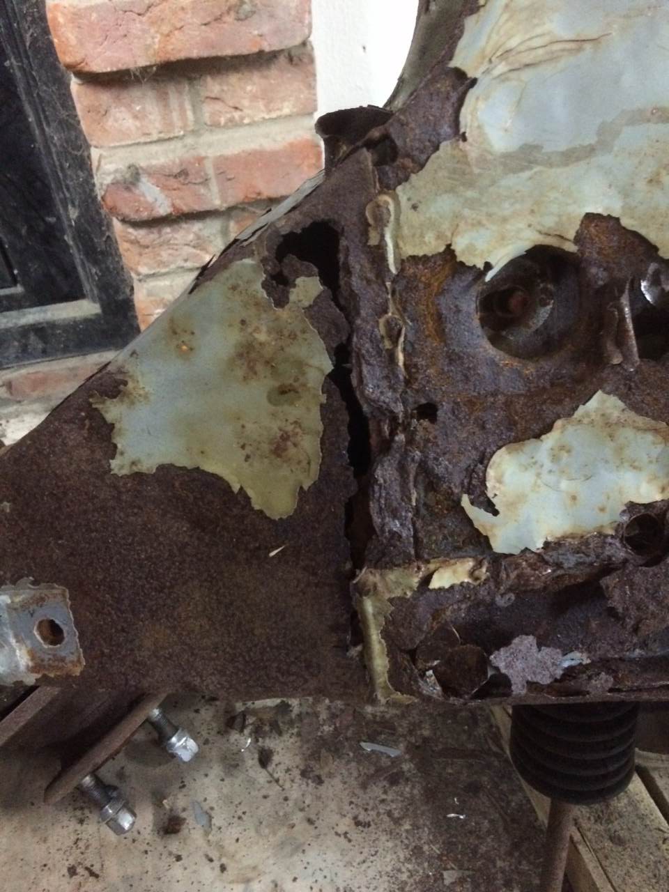

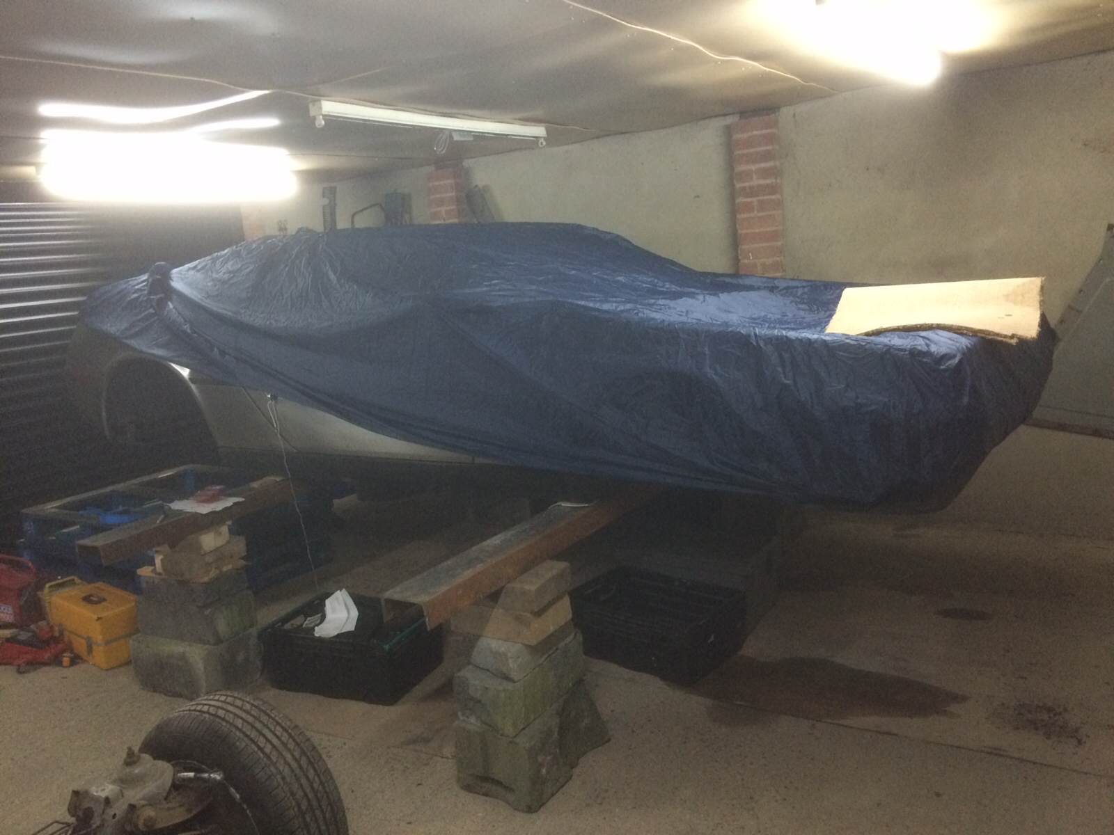

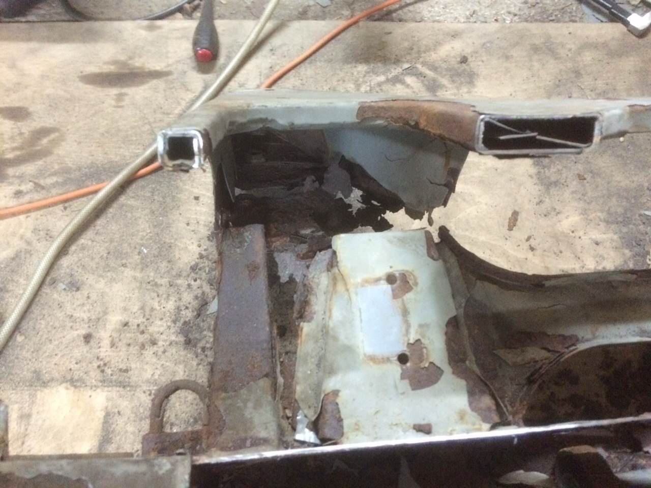

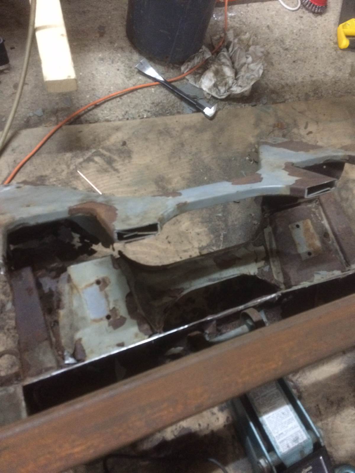

Postby carl hammond » Wed Apr 15, 2015 5:26 pm

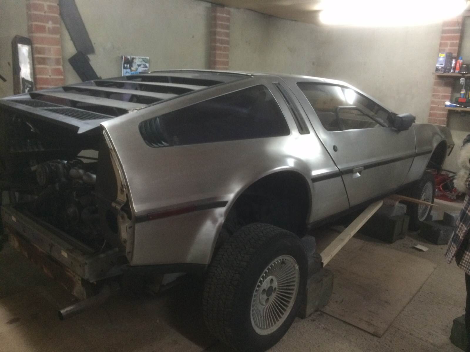

Restoration pics, posted on behalf of Alex :D :thumbsup:

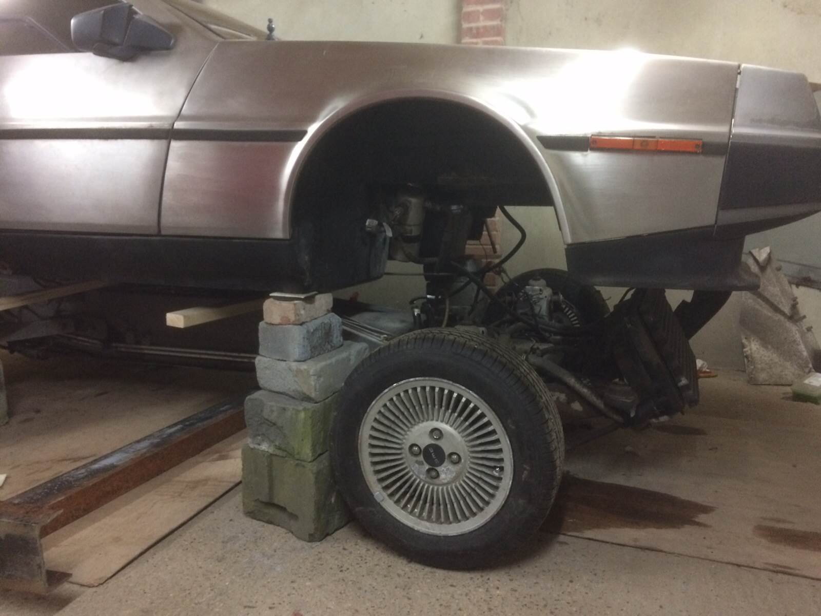

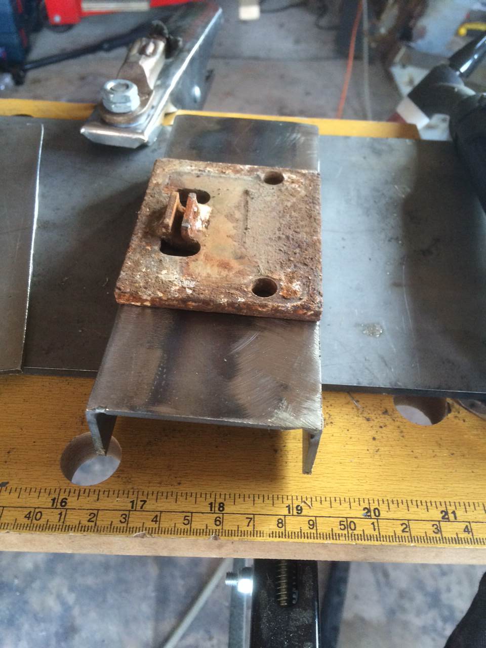

Postby carl hammond » Wed Apr 15, 2015 5:29 pm
More...

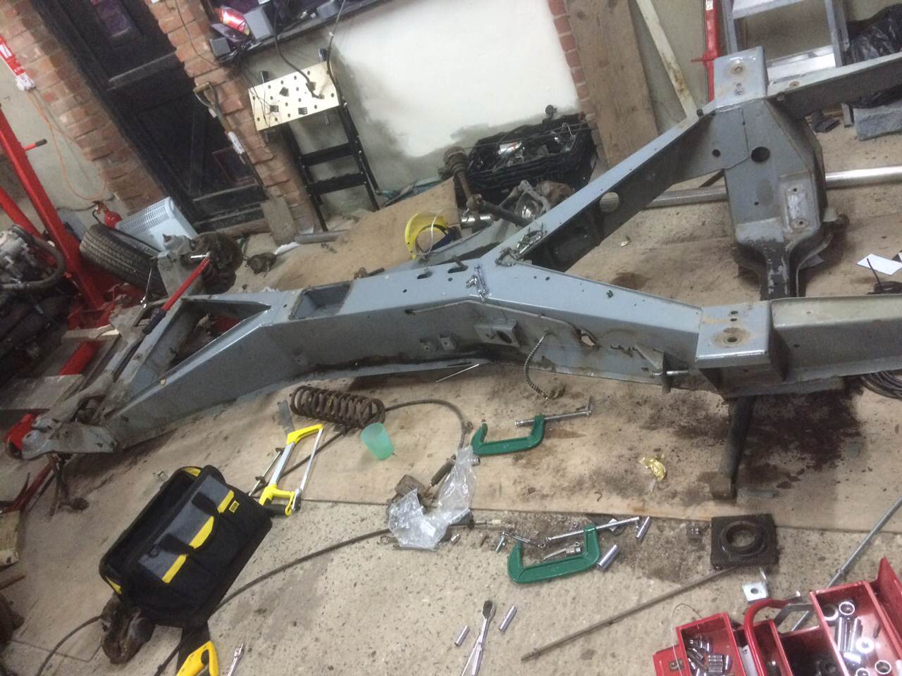

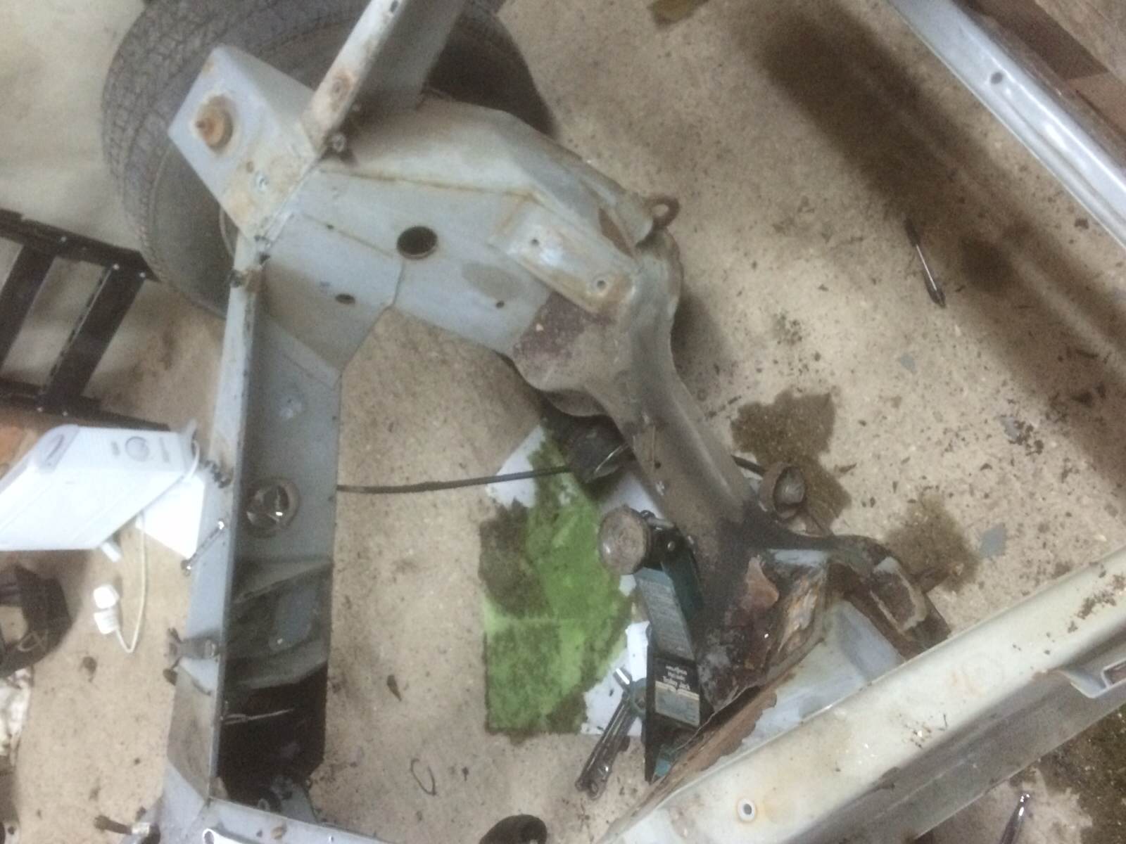

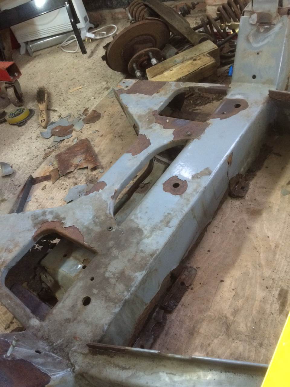

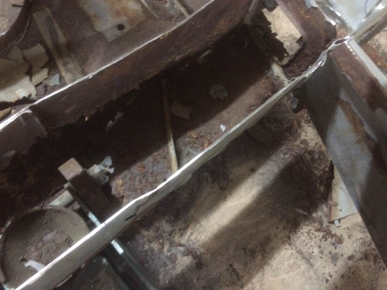

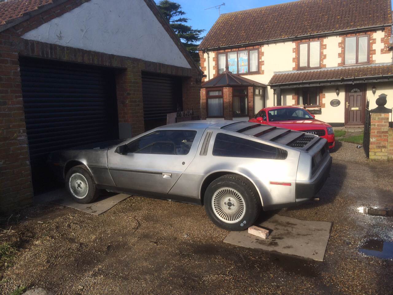

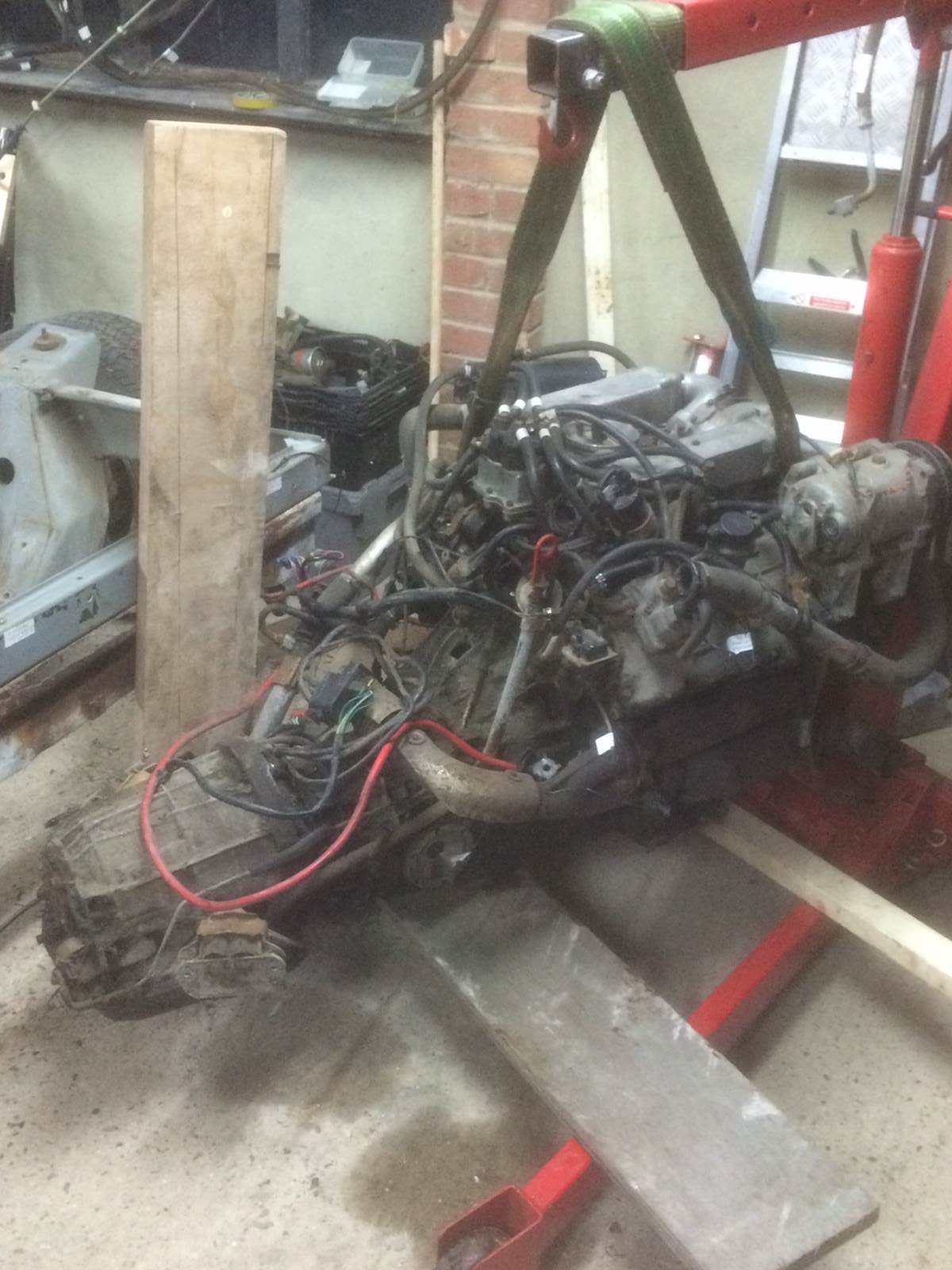

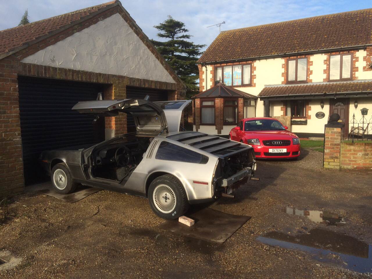

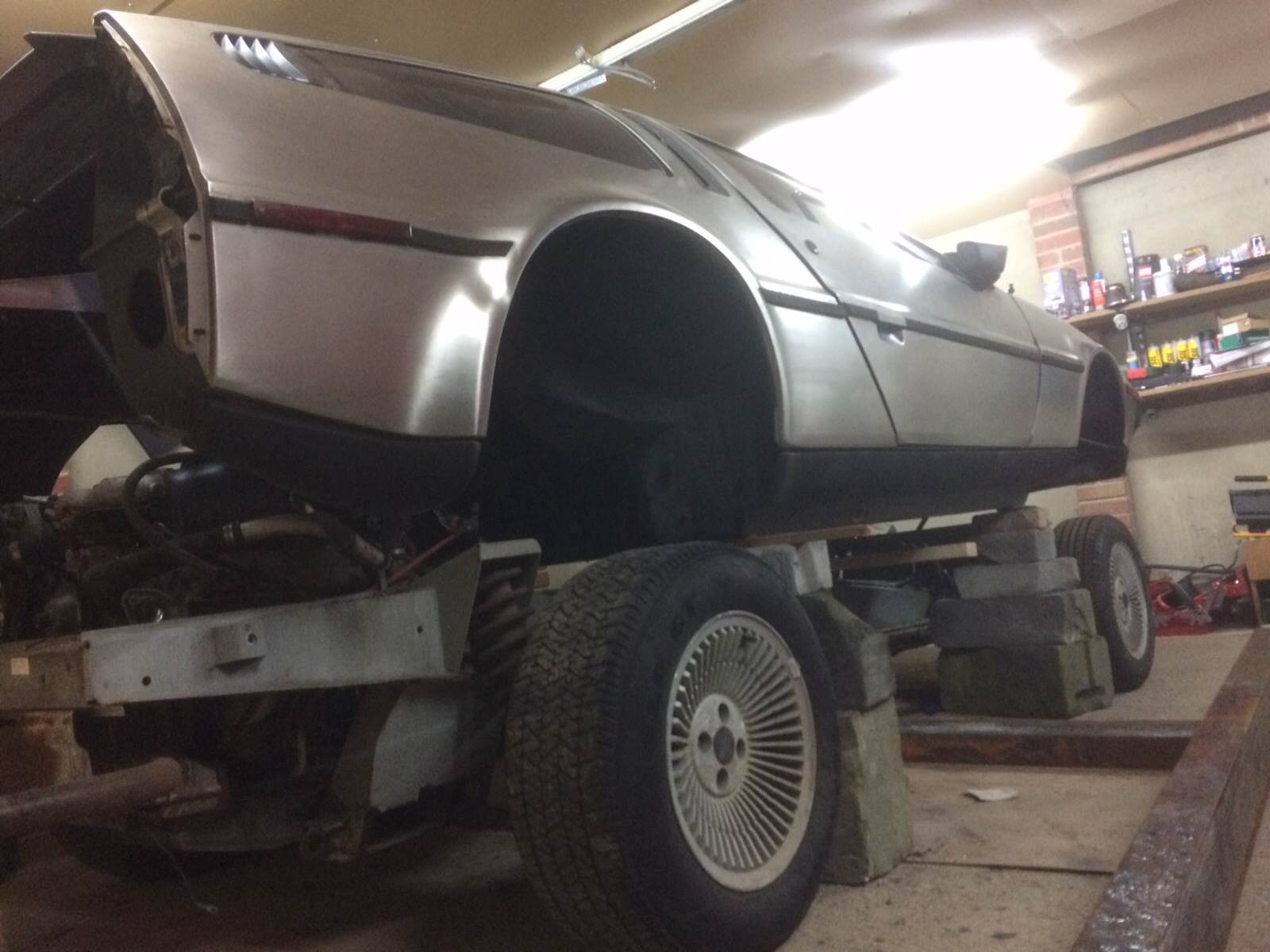

Postby carl hammond » Wed Apr 15, 2015 5:30 pm
Latest progress... You can really start to see some of Alex's fine handy work! :thumbsup:
