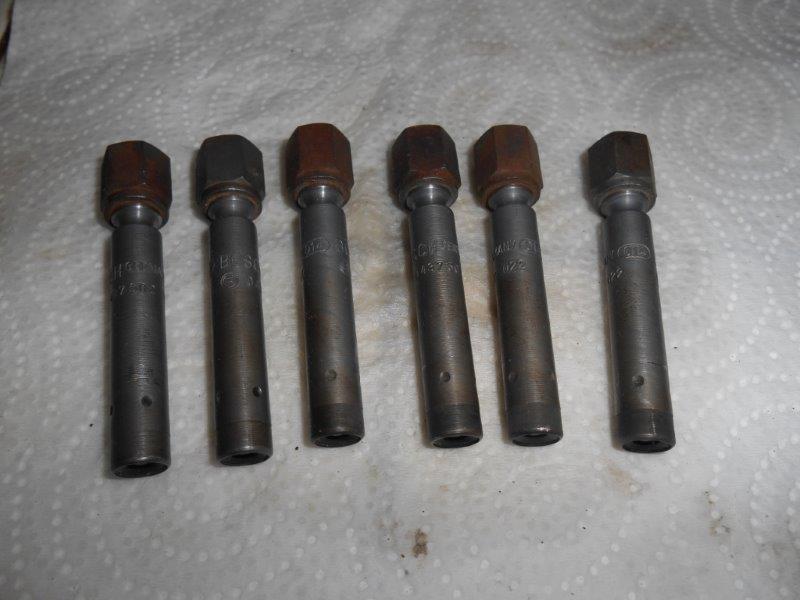

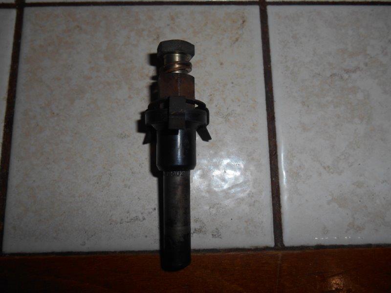

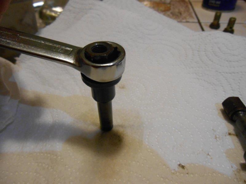

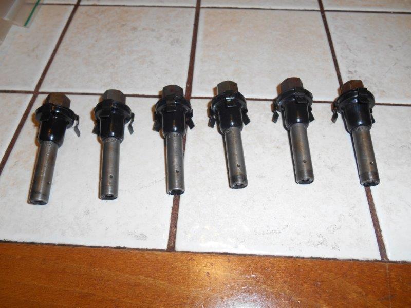

Injectors are ready for a new seal and a new hook

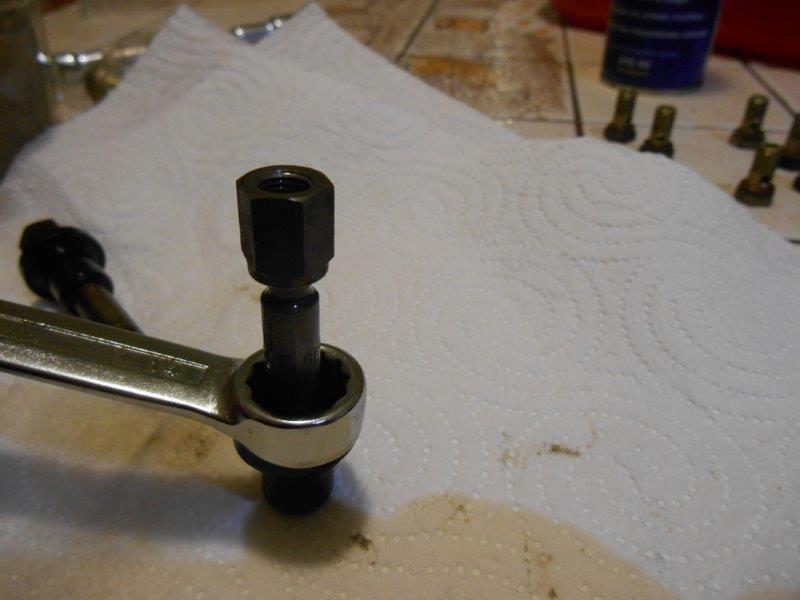

Not so easy to remove and to put on the new one

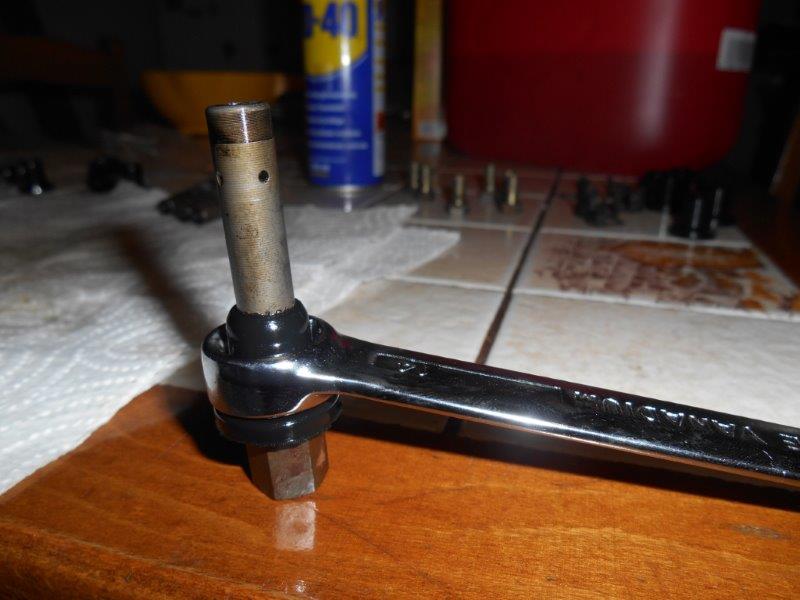

Soak in WD40 and with the help of a 14 wrench push to remove the seal
Same thing in reverse to put the new seal

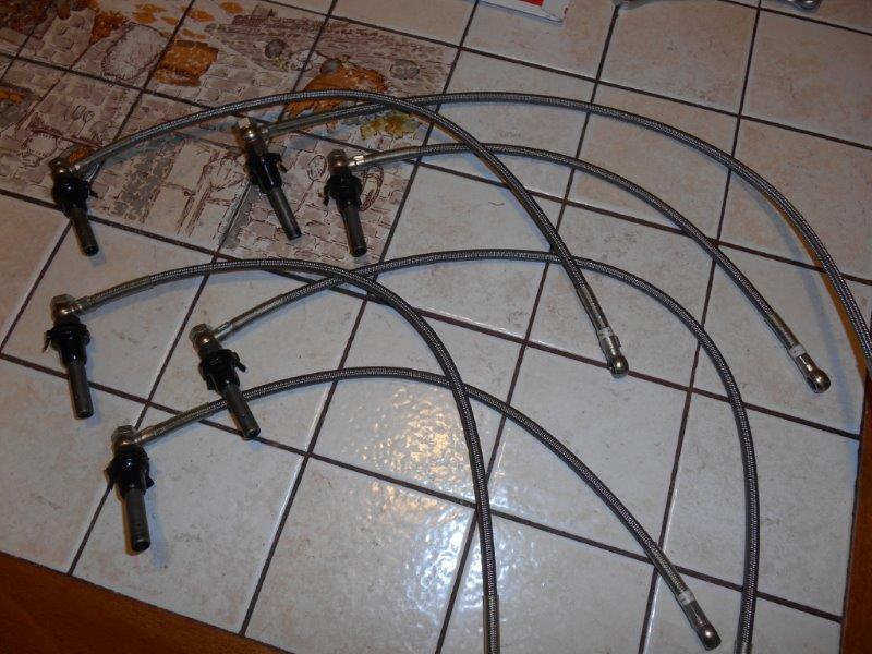

Injectors are finally ready

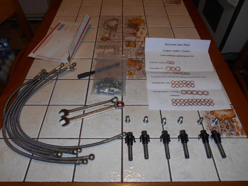

With the new stainless steel fuel lines

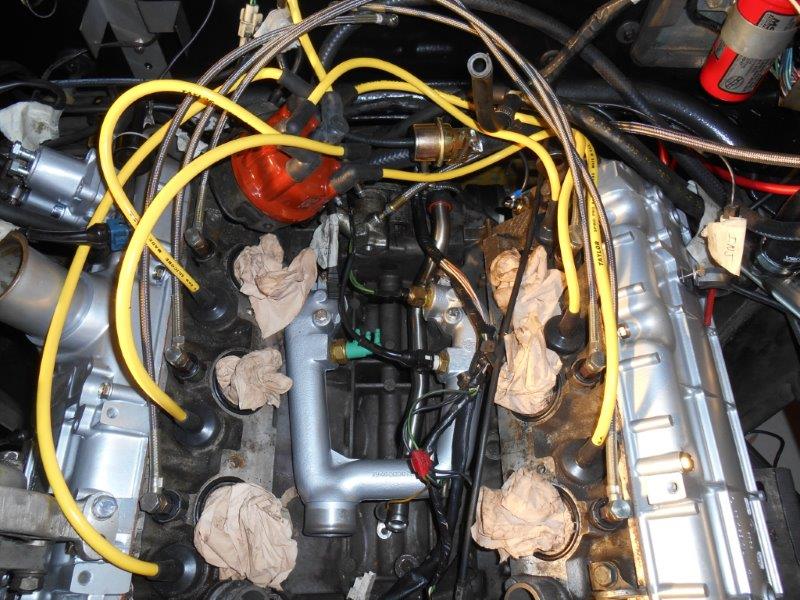

In the engine compartment
Postby Admin-bloke » Mon Feb 22, 2016 9:46 pm
Looking great there.
For replacing injector seals, I use a deep socket and a rubber headed hammer to drift them off.
viewtopic.php?f=17&t=119&start=20
